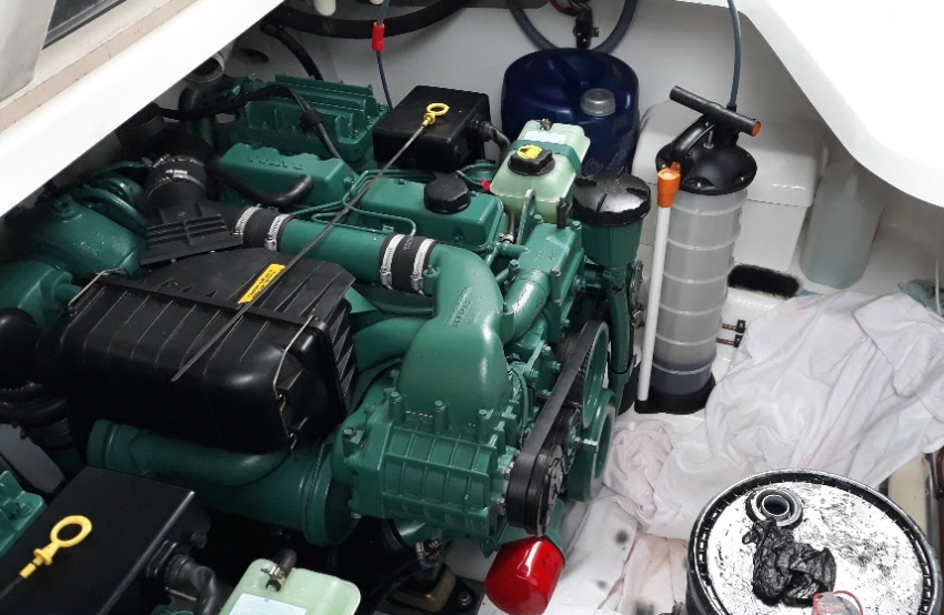

Is the kad32 an easy engine for diy maintenance?
I do routine maintenance myself . Engine oil changes very easy . Very good access to the oil filters , fuel filters , air filter and impellers. Coolant change also very easy.
Oil filters and air filters are as per a Volvo 240 car so relatively inexpensive . I do an oil change annually.
Work in progress...............
Greasing the steering is a bit of a pain .
Sterndrive anode change and oil change is quite easy too .
