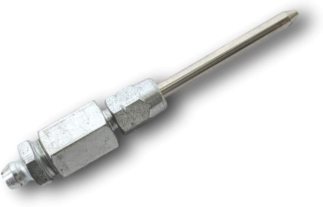

This would solve the problem .. just plugs nito the normal coupler
BTW ITYWF that the "extra collar" you referred to is an alternative to the one already fitted to the needle to make it compatible with different guns
That doesn't look like the OPs
