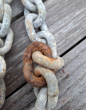

Pictures shows new chain and the reason for replacing.Screenshot_20250315_224051_Gallery.jpgScreenshot_20250315_224021_Gallery.jpg

Intrigued that one link should be so badly rusted. I do see, however, that if that's your old chain in a pile on the finger pontoon, there was a lot of rust.

I agree with Norman - odd that you have one, isolated, quite badly corroded link. The rest of the chain, either side of the badly corroded (its flaking rust) seems in really good condition. I'd have cut that link out and used a "C" link joiner. I also note this is the old chain, seen in the background (and some of the old chain looks good.

The link shown was one of several patches of similar or isolated links. I bought the boat with the chain 5 years ago and the chain was obviously old. I cut the bottom 10 metres off, and the top metre, end for ended it and have used it for several seasons. I had about 45m up to that link. I normally anchor in 5 to 10m so not a restriction plus it's 10mm chain on a 36ft boat (let's not go into that!).
I washed it every time I was in a marina and that slowed further deterioration but decided it was time to replace. I have cut it up and used the good lengths (which were rust free) to replace my even worse kedge chains (2).
The only explanation I can offer is that the chain was probably old - possibly over three decades - and that it had been sat in the locker salty for well over a year with damp ropes before I bought the boat. I don't understand why one link goes so badly - it was presumably "the weakest link"?
