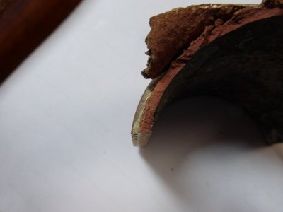

This one had passed surveyor's hammer test 12 months before it broke up when I was removing. All my underwater ones except engine are now TruDesign.
