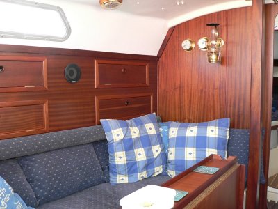

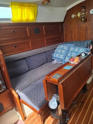

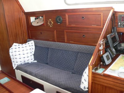

I refurbished my saloon interior in 2010 with international Gold Spar Satin polyurethane clear varnish and has not been recoated since. It still looks great IMO.
See photos
1first two were 2011, and 3rd one not so sunny interior photo June 2025.
Judge for yourself?
