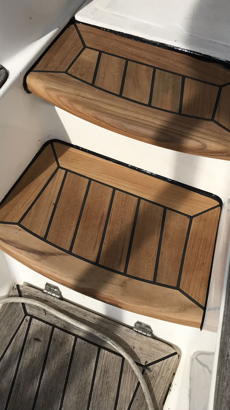

I’ve just replaced my teak steps (no skill, just bought them from the original Sealine supplier and stuck ‘em on)
You can see the contrast with the ladder locker and bathing platform which are still in good condition and good thickness.
Can I just mechanically sand down the old teak to something approaching good looking condition?

I would get some decent brick cleaner & give the old teak a really good clean. flood it with cleaner & work in with a 3 inch paint brush. Then scrub with a "not too stiff" brush although in your case a hand held deck type scrubber may be needed first time. Wash off with water. Do it a couple of times. The colour can be restored very easily & one does not have to spend cash on marine teak cleaners.
I clean my teak twice a year & the acid in the cleaner prevents green mould etc.

I've done this all before.
The 2 part Wessex cleaner and the old TCM method of cleaning will bring the colour back (look back on very old threads).
But that doesn't do anything for the unevenness of the teak so sanding is a solution.
And the Wessex chemical treatment also helps to erode the teak.
The unevenness is usually a result of the old teal wasting away forming ruts in the grain
The caulking doesn't erode leaving it protruding above the level of the teak.
If you use an orbital sander, it takes ages to sand the caulking down to the level of the teak before you can actually sand the teak itself.
Also sanding the caulking can tear the caulking.
Remember this stuff doesn't start very thick (around 6mm) and I expect it is already down to 4mm.
So the caulking won't have much of a grove left.
The solution is to get a VERY sharp wide wood chisel and run it down the length of the caulking thus cutting the black down to the level of the teak.
With a sharp chisel, it comes off like strips of black spaghetti.
Quite therapeutic.
After that, you can then "go at the whole area" with an orbital sander.
This all takes a long time and you will start to see how thin the teak is.
The groves start to disappear completely.

In a word... Yes. I have sanded down both my foredeck and rear deck so far and the difference is night n day.. I wouldn't sand if I didn't have to but if there are ridges or graining you can get a fingernail into, I certainly would. Then once the teak is smooth like the new pieces, I'd maintain them all together (cleaning etc) to keep a uniform look. If there is plenty of thickness in the old teak, you can easily get the old to look as good as the two new pieces.

Many thanks @Daydream believer @Hurricane and @Fire99
Agree with @Hurricane about synthetic, your past pics look amazing and will look the same in a decades time. I’ve only got a bathing platform with teak on and I should really bite the bullet and do the same. By the way I used your recommendation for Arno MP20 sealant with good result.
Good tip on chiselling before sanding. I think it’s gone too far for chemical treatment to bring it to where I want it. I love @Fire99 result and that’s the way I will go.
Is there anything to be gained in chemical cleaning before chiselling and sanding?
Thanks chaps

I hard sanded mine when I got the boat. Had to replace the bathing platform and steps as it was too far gone.
Sealine use solid 6mm teak unlike the ply used eg by fairline of the era.
So you can sand hard but you will find in places the caulking will go as the caulking rebate is only 3mm. You’ll need to use a router to make the caulking rebate deeper and put new caulk in if it does. It happened to me in 2 or 3 places.
Straight edge needed. Screw it down through a caulk line and make that good when done. The consequence of it slipping is significant so weighting it down risky.
The border planks were loose in places on both my S37 and my T46. Lazy install by sealine as the deck moulding was round in the corner but the plank square so it didn’t push down fully and bed firmly in places. They should have sanded the bottom corner of the plank off. If these are bad you can lift and rebed or make a new one if it splits.

The caulking rebate is interesting as a little of my caulking has come away and there is hardly any depth of gap. That explains it.
So it’s not teak strips then!
The thought of using my router on the decking is a bit frightening I must admit.
I only have bathing platform and step teak on my S37 so the border planks don’t apply to me, thankfully.
Thanks for invaluable input.

They are real strips. Bonded onto 1mm (ish) thick GRP at Wattson’s factory to make a big area and stuck onto the boat by sealine.
Plank profile like this so then can be butted together when installing.

I know the tool he is referring to but, IMO, a large flat chisel would be better.
Over time, the teak erodes but about 1mm close to the caulking, it doesn't erode as much.
Using a large flat (and very sharp) wood chisel removes that small 1mm "corner)" as well making the deck smooth, ready for sanding.
I suggest that a wood chisel at least 1" (25mm) wide.
