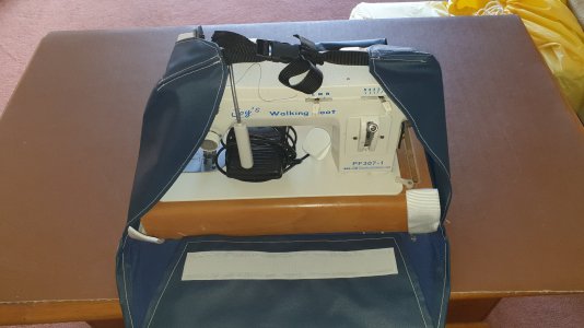

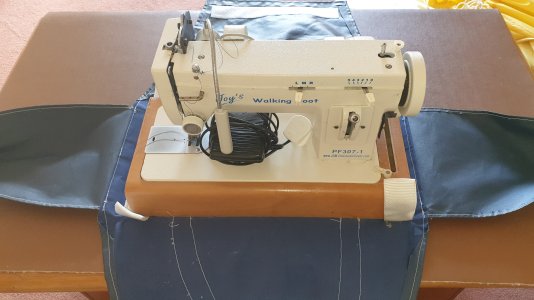

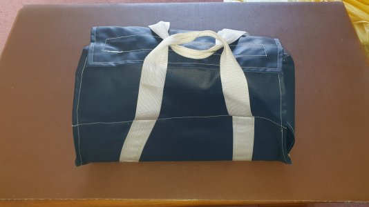

In case it helps others.. The bag I made sits under the machine...
When finished, the sides clip over the top...
Then the front and back velcro together at the top...
It does make it easier (and possible) to put away in an under seat locker..
And the wooden base was just a spare from some other deceased machine, with the storage part to the right cut away to accept the longer arm machine!

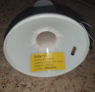

I haven't used V69 for a long time. For many years I used V92 with this machine although for the past seven or eight years I have been using this...
It's a bit of a pain getting tensions correct for PTFE thread, but according to the website, it's a V138 equivalent.
