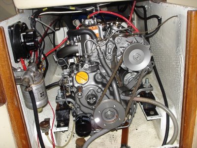

Welcome to the forums. I can't advise on the Yanmar or Nanni, but I found access to the Vetus engine in a Sadler 25 I owned really awkward. Have you asked on the Sadler/Starlight forum/facebook group?
I had an 11HP Vetus in a Sadler 25. The engine was fine, but an issue was access to the bits you need access to. Apart from the alternator belt and the raw water strainer not much of it seemed to be on the front, whereas the 35HP BetaMarine engine I had in a Moody336 seemed much easier to manage. Things like the dipstick and impeller were on the Stbd side of the Vetus (click the thumbnails below for a bigger image) and accessed with difficulty via cutouts in longitudinal bulkheads. Clearly the engine compartment was much much smaller in my Sadler25 but access for servicing and everyday use might be worth checking.
View attachment 98158 View attachment 98164View attachment 98166
The engine was installed ~2001 and the larger ones may be different, but the manual for the 11HP engine refers to the Stbd side as the service side and the port side as the Starter side...
Edit: On re-reading #26 I realise TNLI already knows about Vetus engines(!) but I'll leave my post up here for others.
