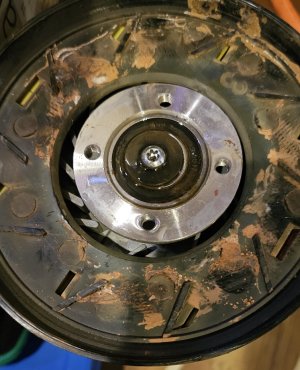

The sander failed this morning, it no longer has the orbit function, the pad spins at high speed and the extraction function seems to have stopped working.
I've taken the pad off, and I can see the bearing, it's obvious sized solid, and the fastening in the centre is also solid.
I've tried the correct size torx key and jamed the shaft. But I applied enough force to flex the torx key (think a typical allen key).
I've applied some "plus gas" and retired for some lunch.
Any tips on how to remove the fastening?
I've ordered a new sander, but that 2 to 5 days delivery, and I need to get on with sanding.
Plus Gas and an 1hr for lunch, eased it enough to get undone, using a 1/4" ratchet. It obviously had thread lock, or similar, it was tight all the way as I unscrewed it.
The Plus Gas eased the bearing, but didn't free it.

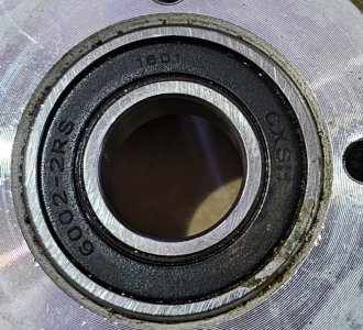

The next task is to source a new bearing. I don't know much about that.
Can anyone tell me what to order from this photo?
I think it's marked 6002-2RS, 1601, GXSH or perhaps CXSH.
Do I need the ID and OD of the bearing as well?
