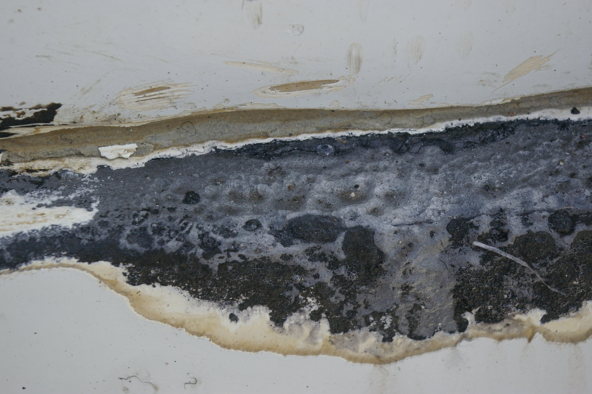

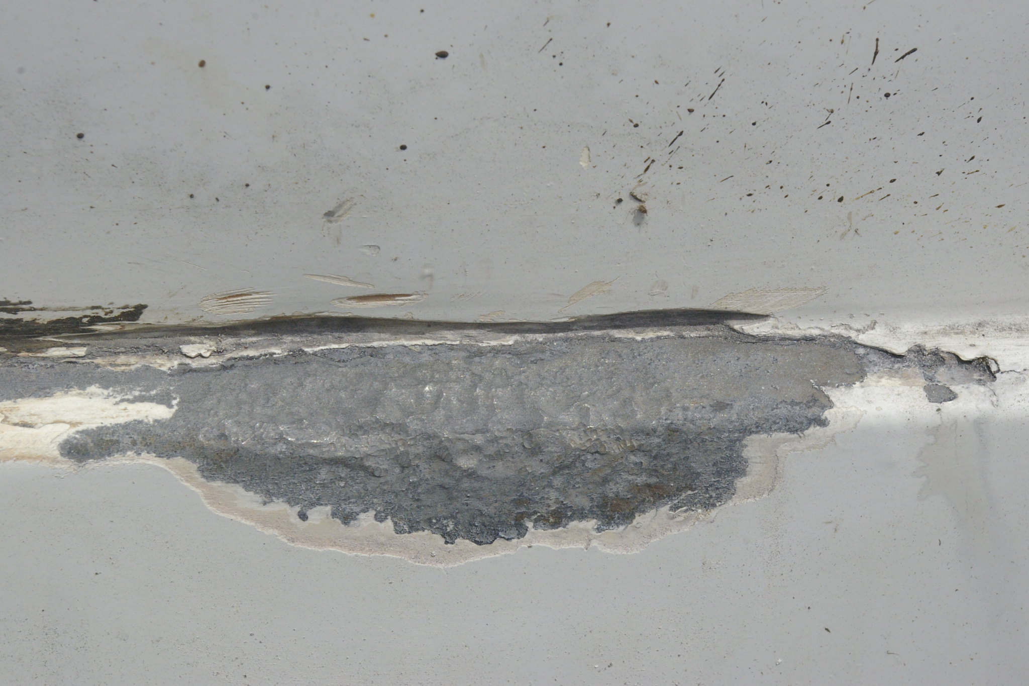

A chipping hammer is the best I have found to remove the black iron oxide which must be remover otherwise it will just come back.
Its not called iron cancer for no reason.
Before chipping
After chipping, same place. A wire brush on an angle grinder would not touch this black iron oxide
