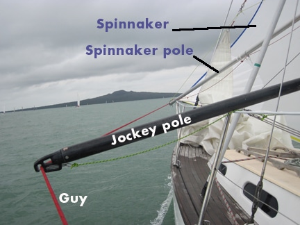

~What are you calling a whisker pole? A pole to boom out a jib clew? (Which is what I think of as a whisker pole).
I call a pole to keep the guy off the shrouds a jockey pole. Guys aren't sheets; the RRS don't worry about guys and jockey poles.
The outriggers on IMOCA 60s are deck spreaders - they're for the shrouds. Their class rules amend 50 to allow sheeting to a them.
The VOR65s had spinnaker sheet outriggers that were attached to the boat (not the mast). Again, class rules amended 50 to permit their use.
In terms of time to drop the second pole when gybing (how many people nowdays have actually done a twin pole gybe on a yacht?), the test would be are you being reasonable in the timeliness of dropping the second pole (subject to all ususal constraints about average crewing ability etc).
