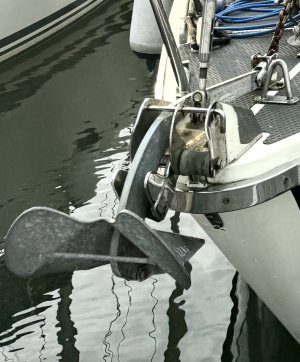

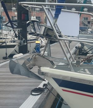

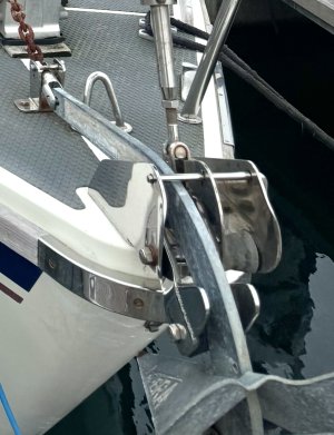

My last question regarding the Rocna anchor is can I use on my current roller? I'm not likely to want to upgrade to this anchor if it means 3-500£ of roller upgrade work as well as the anchor.
These are the only images I have at the moment of the current roller. I've attached the best images I have at the moment as I'm not on the yacht.

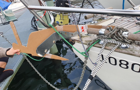

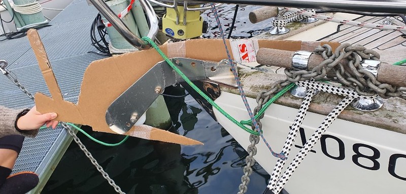

Rocna provides handy PDF templates on the website. Print one out and build a cardboard anchor. Easy to test the fit with that:

I love that Rocna template! Going to cover one in tin foil and carry it, for some oven-ready dock-swinging on my marina-side walks.
