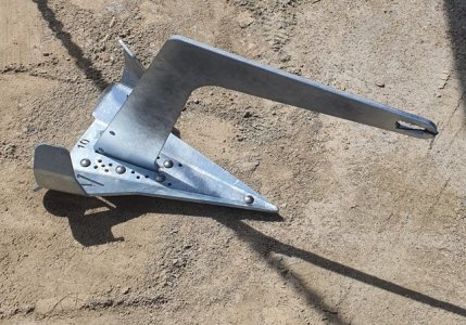

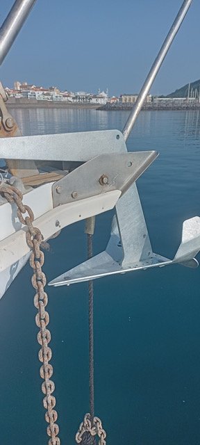

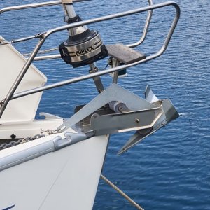

They have hung in and supported the war effort, and, despite the war, introduced a new model, Odin, which was successfully made and tested.
I believe Viking have mentioned on their Facebook page that they are looking at further, or another, production location(s), Australia has been mentioned. Moving production must have been a tough decision (and maybe a bit delayed). But being forced to transfer your production to a safer location is not easy as you need to ensure quality is not compromised. The steel Viking has been using is primarily used in mining and mineral processing and would not enjoy much marketing (and stock) to other industries - hence Australia being high in the mix.
