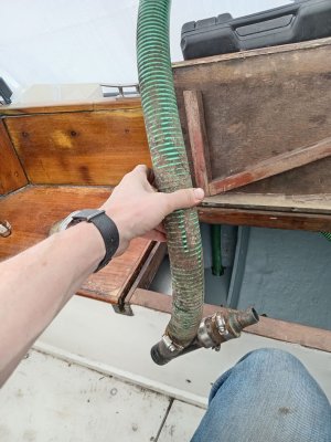

I had to move my bilge hose to get at my fuel tank. I've got the fuel tank back in place but the rigid hose is not playing ball. Can't seem to get to bend at all... Would it be easier if I bought some new hose - is it more flexible when new? Thanks!
This stuff:

I use a domestic steam cleaner to soften hoses, just take care not to scald your hands. keeps the hose workable for as long as needed without risk of burning or melting.

. . . Would it be easier if I bought some new hose - is it more flexible when new?
Yes, on both counts. Old hose that type definitely gets much stiffer with age.
You might manage to get the old hose on with heat, as others have suggested. You might even (though unlikely) have to use heat on a new hose in cold weather, but it will certainly be easier to do - with or without heat - with new hose.
