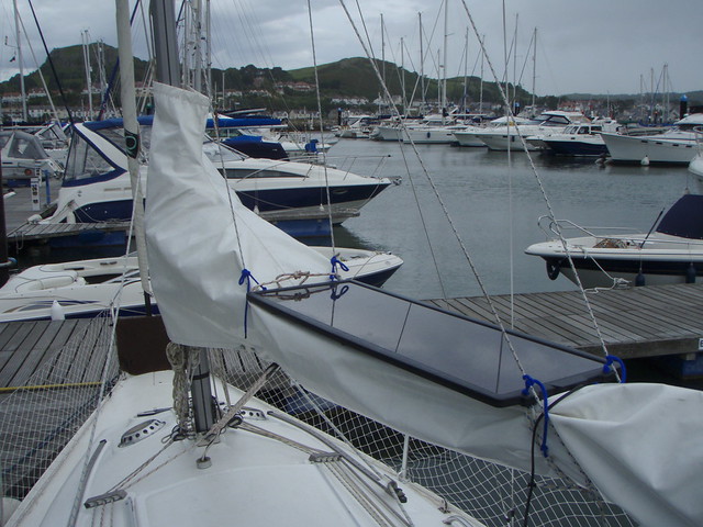

We keep ours here when not sailing:
I'm not in favour of these temporary installations. Best to find a permanent place for it attached to the boat not the rigging even if the aspect is not optimum. Many solar panels are OK to tread on (although I try to avoid it).
