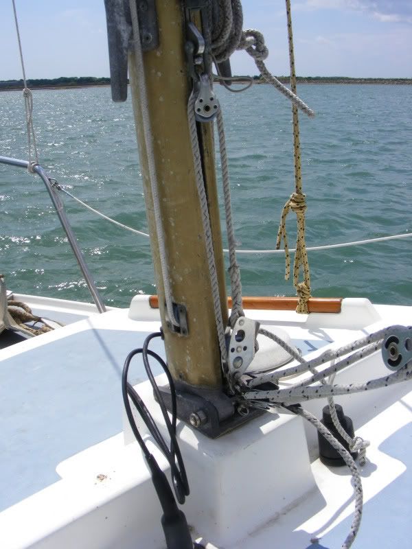

My boom down haul is a simple 2:1 purchase ( ie single block top and bottom) with a jammer on the bottom block.. That was part of the original rigging for the boat
My kicker is a 4:1 purchase ( ie double blocks top and bottom) with a jammer on the bottom block. There is a wire from the top block to the key and keyhole plate on the boom.
I have a shackle around the centre part of the mast step pivot bolt. The down haul and the kicker are shackled onto that.
Here is a photo that shows my down haul and the main part of the kicker.

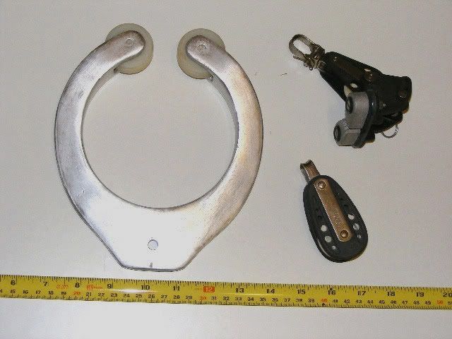

If you use a kicker with roller reefing you need a claw ring around the boom to attach the kicker to so that the boom can roll. There has to also be a guy from the ring to a swivel on the boom end. Here is diagram that shows the arrangement
This my old clawring
Slab reefing will give you a better sail shape, mainly because it is possible to tension the new foot.
The roller reefing tends to end up with the end of the boom drooping into the cockpit.
Slab reefing enables you to fit a better kicker without the claw ring which is far from satifactory
