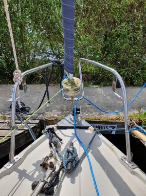

Strange ... my 608 / 609 has a wire rod based feeder .... part of the original kit ...
Sorry I cannot show the underside ... I was hanging over pulpit then to get these shots ....
The guide is a prebent rod affair that then has a plate under the drum that sits with the mount ... the drum free to turn above it. I think it is extension of the base part - so I don;t think the guide itself is available separately ...
Strange ... just been looking through the 608 / 609 manuals and they only show a feeder on the 406 .....
The feeder on my 608 / 609 is definitely an OEM part included in the kit .. not a modification or 3rd party add on ... its actually all part of the bottom plate that drum and bearing sits on ... and mounting plates bolt to.
The only difference I see from mine to later versions is mine does not have the 'cheek sides' to the drum ... mine is the older open drum type.

I used a simple long twist shackle.
PBO Magazine had it in their 'top Tips' years ago.
Drill the drum midway on one side of the line opening, fit shackle, thread furling line.
Simples.

Just for clarity, the vertical 'cheeks' don't rotate while the disks attached above and below the rotating drum rotate with the foil.
So the long twist shackle is attached to the side of the appropriate cheek once a hole is drilled?
Maybe reinforce the hole with washers each side?

I've attached a photo for clarity.

No need to reinforce, it is just a guide. I fitted a new 608 to a Hunter 27 OOD. I am sure I was able to put the 'cheeks where I needed them.

I fitted a twisted shackle and it works fine.

Yes. I have my furling line on port side, runs along side deck through small pulleys and then up through a twisted shackle on pulpit to the port side 'cheek' of drum. 5mm twisted shackle attached mid way up the edge of said 'cheek' guides line into centre of drum.
Hope that makes sense. Pics later in the week if needed.
