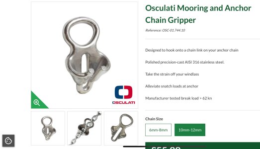

Remember these simple rules :
3x :oops: :poop:
4x :) plus a bit, is my preferred 'minimum'
5x :D
6x :sleep:
Horses for courses. All depends on crowding, bed, sea state and wind conditions of course.
Don't forget to make up a good snubber though. Also you can always add a weight to reduce swing if its really needed..!

Ah the old snubber debate. Each to their own but fwiw I never use a snubber. Anchoring isn’t about staying put; it’s about getting out when you need to. When the weather turns lousy and you wake up to see another boat dragging towards you, the last thing you want is a tangle in your shoelaces.
Mmmmm I do know what you mean, but on a 45' boat its relatively easy to rig a basic “snubber” out of rope attached to the anchor chain and secured to 2 bow cleats, just to take the snatch load off the winch and stop the blooming chain rattling on the bow roller at night, remember JFM, on a tiddly little P45 the master cabin is at the bow ;-)
Rigged right, it can easily be released, or even cut quickly if needed.
