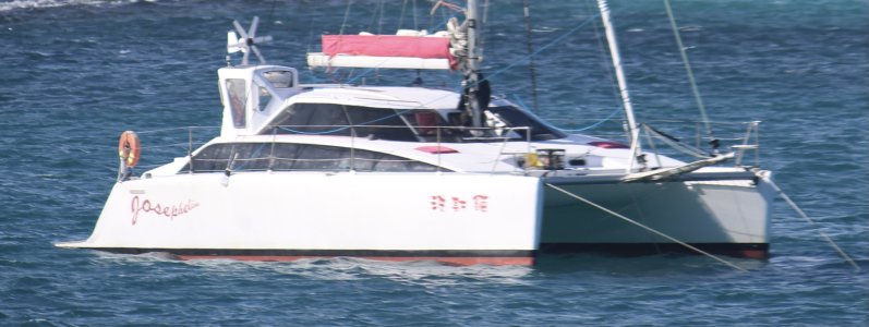

I have a catamaran with large bridge deck windows. They are currently stuck on top of the GRP (VHB tape and Sika) but are now scratched and also since the decent Sika primer was scrapped the new stuff is lousy and has let through some leaks over the last 7 years of use .
So I plan to change them this autumn and change how they fit. The plan is a GRP frame on the inside of the window opening, which means 8mm glass or acrylic will sit on that frame and stick with the new MS polymer sealants. The window panels will be about 3-5mm smaller all around than the opening. The GRP is 5-6mm thick so the "glass" will stick out a couple of mm and the gap around the "glass" will be filled with sealant and nicely finished in to the protruding edge of the pane
I can go with 8mm acrylic or polycarbonate or 6 or 8mm toughened glass. Obviously glass is better for scratches etc and should remain clear forever but.. will movement in the boat cause it to crack? It will be supported on all edges by 30mm of GRP lip to sit on and surrounded by a 5mm flexible sealant gap and then the GRP of the coach house. There have been no signs of gelcoat cracks etc over 40 years on the coach roof but it will move like any GRP - my instinct is that a 5mm bead all round will provide enough flexibility to protect the glass (similar to what is in an ally framed window) but does anyone have any experience that may say different ? TIA
