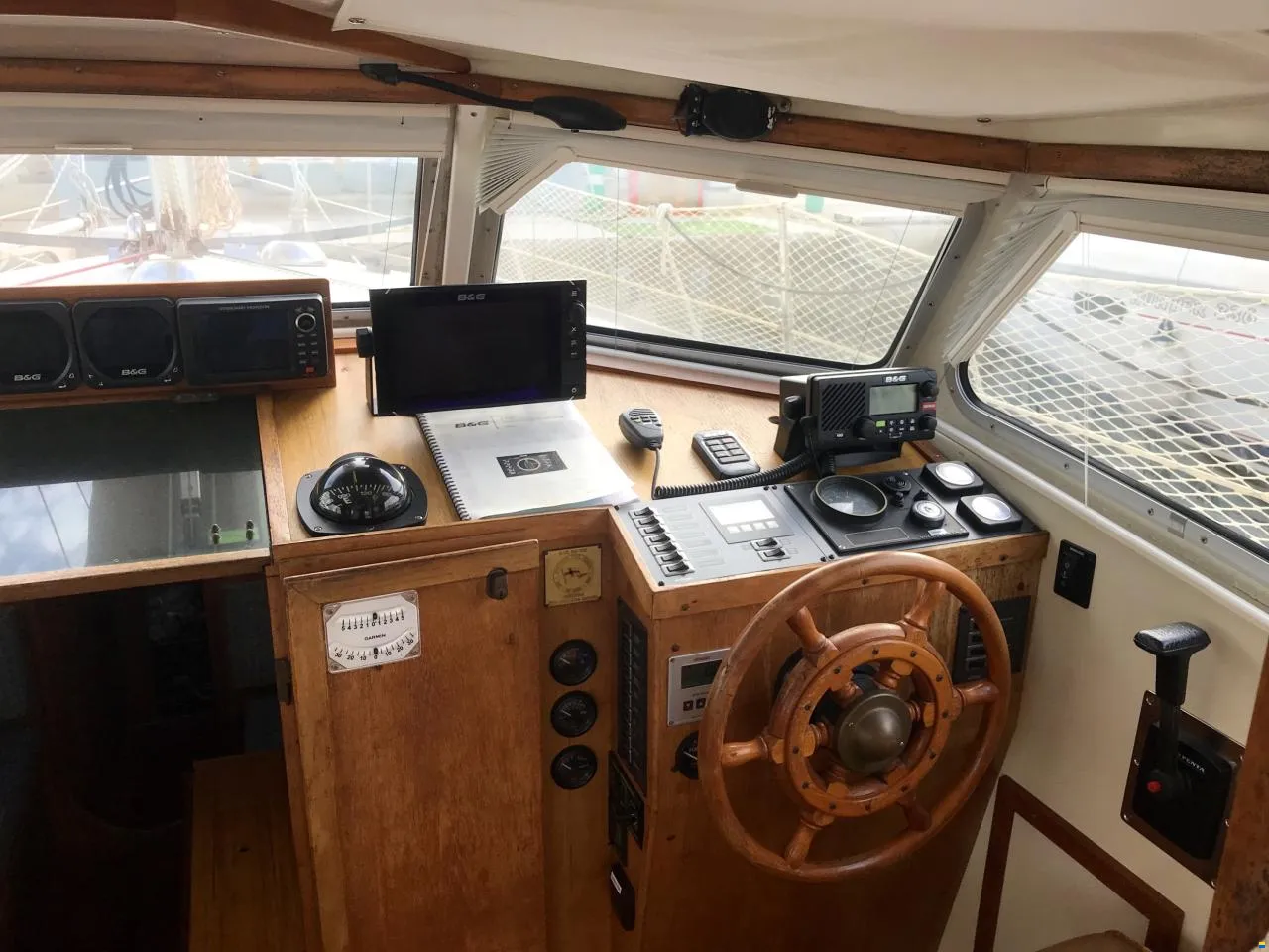

Is it like this >
Mascot Boats Mascot 28

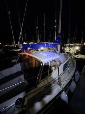

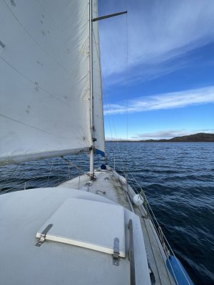

Thanks for that Tranona, that photo 6 is like mine, and obviously had the replacement done, only 1 hatch on mine above the wheel. I attach a couple of mine now
