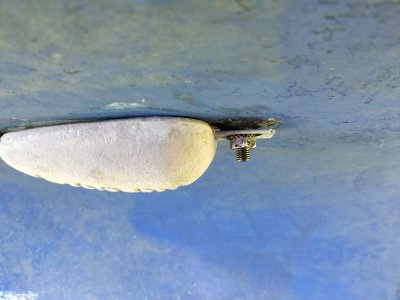

I have today replaced the anode on my motor cruiser (moored and only used on the non-tidal Thames, so "freshwater").
On fitting it, there is a problem - see photo. The fixing brackets on the new anode are not flush with the bottom of the anode, whereas they were on the worn anode I removed. The new anode is a genuine MG Duff product.
The problem is that on tightening the nuts and getting the anode base flush and tight to the hull, there is a gap of about 5 mm between the underneath of each bracket and the hull (which is GRP).
This strikes me as a potential 'disaster' in waiting when sailing along: all sorts of debris could get caught in the forward gap (and maybe the rear somehow) and it would be impossible (I think) to be able to remove this when the boat is back in the water for the season (my boat is craned out of the river over winter).
I think I need to fill these gaps before craning back in to create a smooth profile so that nothing can get caught up whilst sailing.
Anyone had a similar problem and/or got any suggestions as to what I can use to achieve this? Obviously needs to be waterproof but I'm not sure what will permanently stick (and stay in place) on the metal brackets and the anti-fouled GRP hull.

Leave it alone ...........nothing wrong with that anode or the gap.
If you want to be really fussy it is not unknown for folks to buy sheets of thin rubber and install between hull and anode.
Cut rubber to shape of anode after fitting.

The last Duff anode of that type which I bought came with a dense foam rubber mounting pad a spare nuts and spring washers.
That foam backing pad between the hull and the anode is really important. It stops wasting of the zinc from the underside of the anode. There is only a limited volume of zinc on the uderside of the slightly curved steel bar that projects out of each end. Once that zinc is lost the rest of the zinc falls off the steel bar leaving no protection. The next to go will be the zinc plating on your anode studs then the studs start corroding.......

Thanks for the replies. I have visited the shop where I bought the anode and purchased a suitable backing gasket. Their view was that a gasket is not necessary, but it does no harm to fit one. I didn't argue but will err on the side of safety and fit it tomorrow.
The idea of the "gasket" is probably that of cushion so that the anode does not leave unsightly indentations in gelcoat ?
Usually only found on plastic boats,nobody bothers on working commercial steel boats.
Don't know, I was more concerned by @Plum's post above. I have no reason to question him but I need to take the anode off again to replace one of the washers on one of the studs, so may as well fit a gasket. As my hull is GRP, your comment about not leaving a 'dent' also makes sense.
