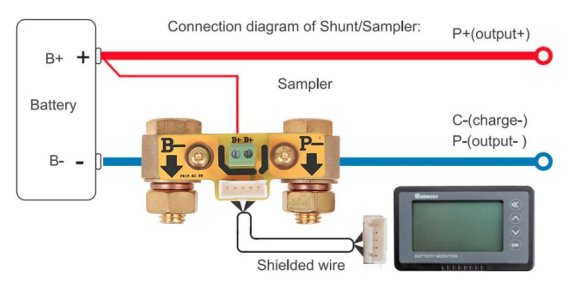

I am in the process of fitting a Renogy Battery Monitor (see here) and am not sure where to place the shunt. Renogy show the wiring for a single battery which is simple (even I can understand it):
The key point is that the battery negative is the only thing that connects to the B- stud on the shunt. But where does the shunt go when you have two batteries, one engine starter and one house (domestic) battery? I have a BEP VSR (voltage sensitive relay) that controls the charging and the wiring is set up as in this BEP schematic but without the optional extras:
I want to monitor the amps in (from engine alternator and solar panel when I get round to fitting one) and out of the house (domestic) battery. Does the shunt go in position A or B? Most of the recommendations I have seen suggest A is the correct position (B- to house battery negative, everything else negative including the engine start battery onto the P- stud), but I can't get my head round how that picks up the charging amps from the engine alternator going into the house battery when the engine is running.
