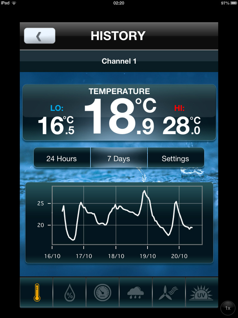

Here are the graphs, there's only one temp / humidity sensor connected I'll connect the next two this weekend. It will be interesting to see the delta between outside temp and engine room.
Temperature history for past few days, surprised how warm is gets in Saloon. The Meaco DDL8 De-humidifier kicks out some heat, when it operates but not much (about 300W from memory on medium setting).

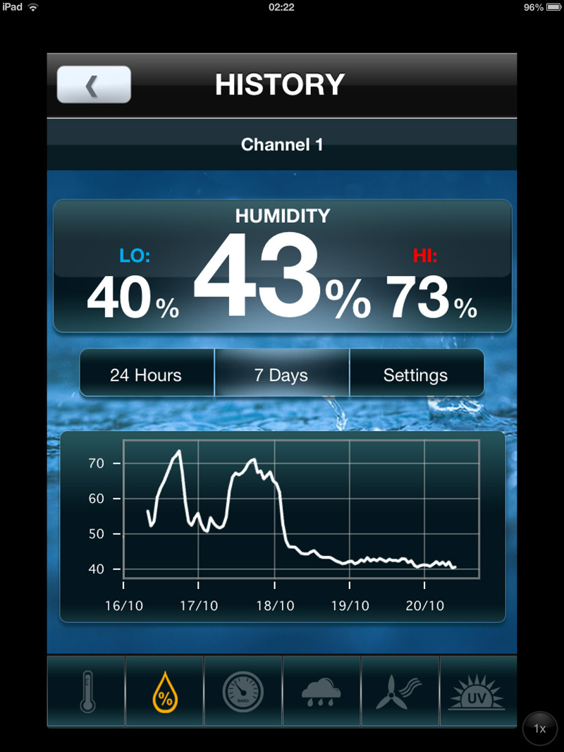

Humidity for past few days - I spent Thursday night and Friday night on boat last week, the humidity increases while I'm onboard then settles out from Sunday onwards as Meaco goes to work.
