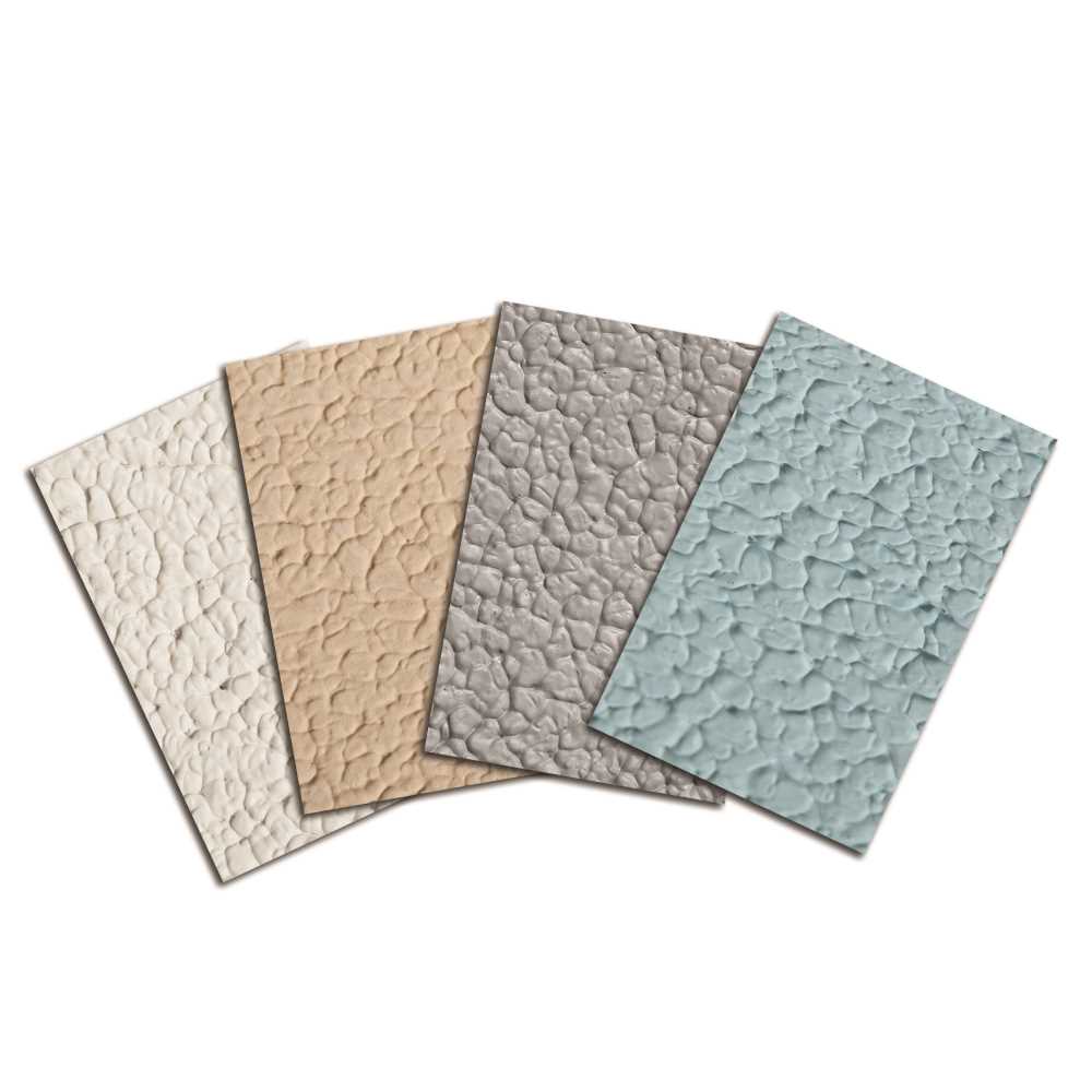

As a consequence, we checked one of the bow hatches that were removed against the Kiwigrip sampler at the dealer shop, and we found that one of their few standard colours (the one called "cream", unsurprisingly) is very similar in tone, just slightly darker. So, that was an easy choice.
It's almost impossible to compare colors based on pics, but just in case anyone else is interested, below are the base colors available, to give an idea.
Being water based, the stuff can also be colour matched by adding up to 2% colorant (therefore with a limit in how dark you can go), but we preferred to stick to one of the base colors and avoid fiddling with it other chemistry.

my monitor setup here at home maybe crap, I'd expect you chose the first on the left, second on the left looks way too dark here for a Ferretti gelcoat!

Nope V, first left is what they call "white" - and it is, in flesh.
"Cream" is indeed the second left, but it does look darker than in reality, in the above pic.
Pics aren't accurate at all, in fact. They call the first right "blue", go figure... :D
Btw, if you looked at the pics I previously posted of the boat, the gelcoat actually appears lighter than it really is.
Bottom line, the difference between the real KG sample and our hatch was not much.
Yes, the KG stuff still is a bit darker than the boat gelcoat, and it could be made lighter by mixing some white parts, but we believe it's actually better to have the antiskid surface "distinguished" from the rest of the gelcoat (as in the Nordhavn with white gelcoat and grey antiskid).
