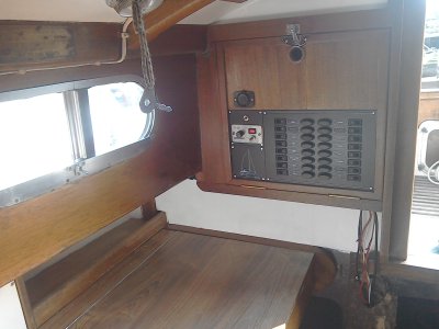

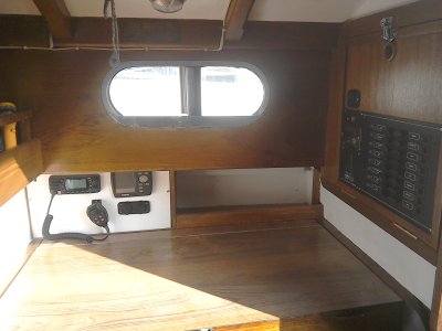

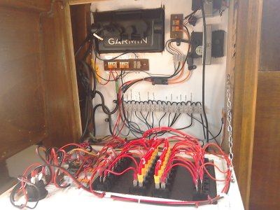

I have just done a 31' sailing boat. New batteries, switch gear, split charging cabling, chargers, 12v distribution panel and all wiring except for interior lighting circuits plus 240v shorepower. Material cost around £2k and lost count of the hours. Photos show main 12v DC switch panel to give an idea of the amount of work involved in just connecting things up Work in progress at this point.
