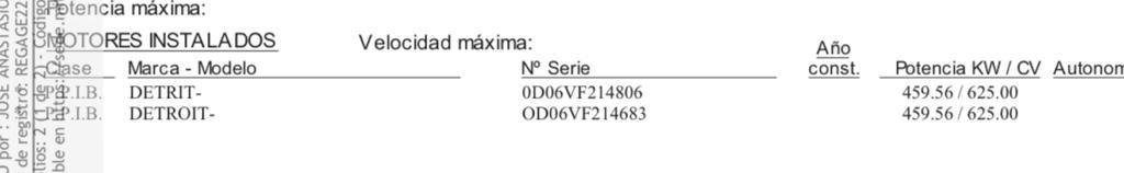

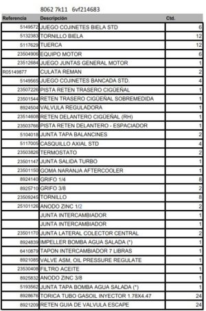

Sorry confused and need to make sure I am buying the correct engine from the IS after the Spanish dealer just quoted 40k to repair the current engine…
Can anyone tell me if this engine will work with my electrics?
My engine code is 6v71 on one form and the below in a quotation
No serie
06VF214683
Modelo
80627K11
“DETROIT DIESEL 6V92 TAB 565 HP. DIESEL MARINE ENGINE w/ TWIN DISC GEAR RTO USED”

At 625HP, your engine cannot be a 6V71 !! The only engine at that rating was a 6V92 DDEC with electronic governance and injectors ... so what you will need to look for is a engine with that name/code combination ...
Such as... Detroit Marine Diesel Engines pair 6V 92 TA DDEC 625 hp 24 volt plus extras • £13,000.00

I would advise , get the engine numbers off both engines and gear boxes . Then check with DD in the states that they are all matching pairs , and ask for replacement model numbers .

My engine is a Detroit Diesel 6V92 2 stroke Engine. 6VF214683
If anyone knows of any for sale or rebuild kits please let me know.

A quick Google =
The first one seems better it drills down into serial numbers and handing , which is what you want .
Detroit Diesel 6V92 Turbo & Non Inframe-Overhaul Engine Rebuild Kit
In-Frame Overhaul Kit Fixed Detroit Diesel Engine 6V92 Turbo Intercooler - ProDieselParts
