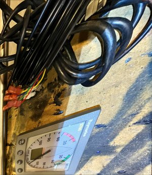

That’s extremely generous.Would a test rig of spare anemometer and cable help. I keep a spare anemometer, a jury rigged shortish cable and ST60 wind for testing purposes, I hate mast climbing as well. I would have responded before but I could not find it. With this I can test various element, especially anemometers. It has 5 female spade connectors which fit the 5 pins on the ST60 wind. With this you could plug in a known working anemometer down below in the cosy and rotate the vane at will and check whether is rotates clockwise, anti and port/stbd etc. But I am not sure if you have sT60 since you have a converter box? Anyway I have just found it in the garage under a pile created by boat decluttering. It is even further north in Inverkip and you would be welcome to borrow it if it helps. I can lend you a ST60 also if that helps with diagnosis. It does not have the RM masthead connector on the cable but a 5 pin DIN connector from Maplin which is an audio connector and works well.

No probsThat’s extremely generous.
My instruments are ST70+ and fed through the SeaTalkNG (near NMEA 2000) network - hence the interface box referred to.
But I assume the vane is the same - so might be able to feed into the box to test?

If it might work I would be delighted to lease from you for a suitable liquid fee

If you can borrow that MHU, which is hopefully known to work, you can connect it to your wind transducer pod. If that works then you can eliminate the pod as the cause of the fault.But I assume the vane is the same - so might be able to feed into the box to test?
