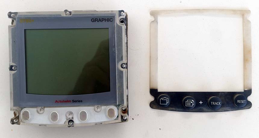

When you say that you bought a button assembly, you mean just the rubber bit on the right side of the pic below, I suppose?
I'm asking because the Graphic and the Multi happen to have the same button labels, so I could as well swap the rubber buttons, together with the bezel.
Which, as I understand, you confirm that is indeed swappable, correct?

Yes indeed it is the rubber bit on the rhs

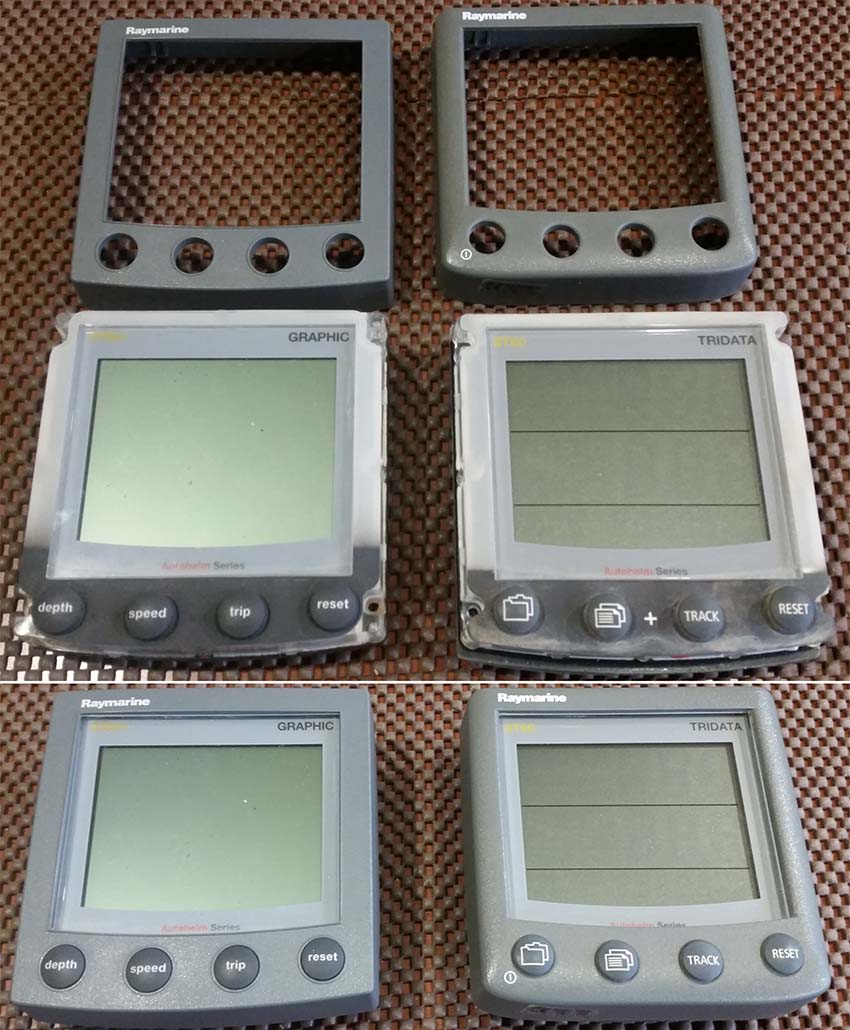

Hi D, good news.
Today I had the opportunity to try a bezel+rubber buttons swap between a non-plus Tridata and a plus Graphic, and it worked just fine.
In the upper part of the pic below you can see the buttons and bezels already swapped, but not yet closed.
The lower part shows the final result.
Mind, the buttons labels don't make sense anymore after this swap, because they are different between the two instruments.
But obviously if you swap the rubber buttons of the same instruments, also the labels remain consistent.
That's what I'm thinking to do eventually between a Multi and a Graphic, whose labels are the same - it was just easier for me today to make the check with the Tridata.
Btw, I also noticed that the non-plus sun cover fits also the plus bezel. Not perfectly of course, but it does fit decently.
So, if on this basis you should prefer to keep your non-plus sun covers, no worries, I understand that!
