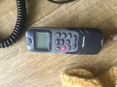

Hi thanks for the offer but on the 240 it's plug one end and wired in to the hand set
Yes that is right - at the mike end you have to open the mike up and the cable is terminated with a pcb type plug/ socket which just plugs in then close the mike back up.
I will take a photo when I get home next week

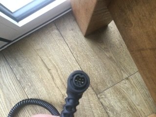

That plug is a ampinol (think that's how you spell it)
And is the same as mine.
I will be home on Thursday I will post it on here Friday / Saturday
