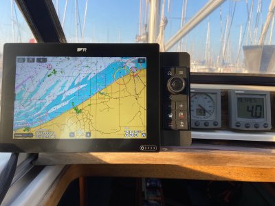

From memory (yes been pondering) Axiom on offer at 40% discount from marine superstore, yes touch screen but you can get 'the buttons ' separately which for me would put tge screen under the sprayhood and tge controls at tge binnacle! Interesting proposition.

The remote keypad is mounted on a black plastic board which is fixed to the plotter. The wires are connected at the back. The whole setup sits in a bracket under the sprayhood and is stored inside the boat when not in use.
You can also get a horizontal aspect key pad also.

Their kit has always been my preference and on our current boat we replaced the old C120 with a new Axiom 12” on the chart table across the companionway from the lower helm with a remote key pad on the helm. Works a treat as I can see the plotter and operate it from the helm seat.

Many thanks for confirming the remote keypad. Going from Axiom to Axiom Pro is a major cost. Totally reliant on touch screen on deck under sprayhood is a leap of faith for a luddite.
However, remote keypad at steering pedestal to control plotter out of reach under sprayhood sounds a perfect answer.
Yes, absolutely.
To be fair the main benefit will be operating it from the helm as we have managed fine with the touchscreen on the fly, which is completely exposed and no spray hood. That said, if it gets too unpleasant we do retreat to the comfort of the wheelhouse! 😁
I didn’t want to depend on touch screen only either and I’m glad I took the keypad. Putting a marker or a waypoint in an exact location when you’re hard on the wind in a seaway is so much easier. You will soon work out for yourself which actions you’re comfortable with on the touchscreen and for which ones you prefer the keypad.
I might also add that coming from my old C120 plotter the Axiom is a serious leap in userfriendliness

Once paired with an iPad or other device you can manage a newer raymarine /Garmin etc from comfort below or under sprayhood of course . Having the plotter by helm is fine but many now seem to fit down by knees which isn’t ideal for waypoints placing unless you with another who helms while plotting on going. The most important feature we use though is AIS when channel crossing but maybe the OPs voyaging area is more coastal where perhaps AIS is less value? You don’t say if you have AIS but if budget was limited if not I would be focusing on a package with AIS send/receive to fit your budget even if it means a more basic plotter unit . If would suggest you might get down to marine superstore at port Solent and have a play or maybe book on one of the courses hosted at raymarine offices which I found helpful when we had new plotter. Ours is older raymarine from 2015 though with touchscreen which I tend to use most -spinning the controls to move cursor etc seems quite alien nowadays but I guess maybe more accurate but we haven’t really had issues generally using touchscreen so I do wonder if the wheel control is essential even without the diy pad shown above.
If you have a remote keypad the screen is still touchscreen so having the ability operate remotely from the helm and also being able to get close up and use the touchscreen under the shelter of the spray hood is the best of both worlds. I actually tend to work using touchscreen at the chart table when passage planning and use the remote for zooming in, switching screens etc from the helm when underway.
