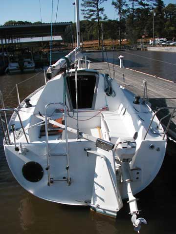

As I understand it, that is what the OP is doing now, and wants to avoid. He doesn't want to take the jib sheets to the cabin top. I had in mind something like this:
This is cross-sheeting to the opposite primary. Although the J-24 doesn't have secondaries on the cabin-top, this approach should still work, leaving the secondaries free. The OP's other problem is that his "primaries" are too small, so he needs to switch them back to the cockpit.

This isn't our boat, but here are a couple of pics just so you can see the layout and how it differs from the J-24:
The boat is wide at the back and has the winches very far outboard. We also have quite high coamings which don't really have anywhere to mount anything (apart from the moulded winch pedestal).
Note how far forward the genoa track is compared to the J/24. I'd say it's questionable whether we'd be able to make the angle work for the Lopez block placed directly on the jib car.
How about a cam cleat mounted on a riser block behind each primary winch? Trimmer pulls in with one turn as far as they can and then cleats. They then take the tail up to the windward primary and load it up. Perhaps we could work the heights out so the sheet then pops out of the cam on the leeward side as it's loaded up. Similar principle to the Lopez but different arrangement.

I see the problem with the geometry. I might be tempted to try some kind of a flying block, tethered to the toerail maybe three or four holes aft of the stanchion. You would have to experiment to get it tethered to the right place and the right length of tether, but it just might give a fair lead to the windward sheet. You might also get away with using an Antal low friction ring instead of a block. Tricky one.
Edit - possibly with some bungee cord to the top of the stanchion to hold it off the deck when it is on the windward side, or maybe some bungee cord taken forward a few holes in the toerail to keep it on the deck.
bbg
2 May 2005
6,780
OK, as I've thought more about it, if you were going to try a block / low friction ring on a tether, it would be better to have it tethered to two places on the toerail.
One aft, about three or four holes aft of the stanchion. This tether would take the load of the turning force. A second tether, which could be lighter, would be directly outboard of the flying turning block, to prevent it from moving too far inboard as the pressure comes on.
I'm not convinced it would work, though. The geometry is such that the sheet might still rub over the leeward coaming. As I look at it more, I am almost certain of it. That leaves the option of building up the winch base to permit the installation of a block there.
In either case, cross-sheeting might require the adjustment of the angle of the winches themselves. They work within a band of angles of the line coming into the winch.
