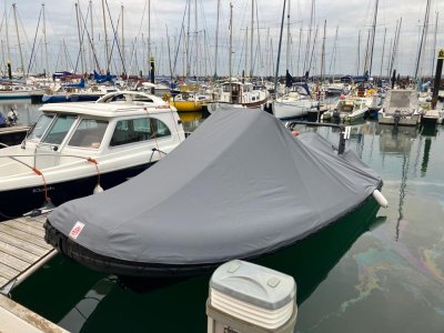

The cover for my rib has a sit on each side so it slides past the radar arch and covers the engine also. Admittedly this cover also cost around £900 but you could maybe tweak a cheaper cover similarly. £900 sounds extremely cheap for a 5.4m rib. I think a radar arch looks great and great place for nav lights, life ring and rod holders in my case
You'll struggle to mount any nav lights, vhf etc at any reasonable height without a radar arch. Most RIBS just have covers over the console, helm and jockey seats. All over covers nearly always sag and fill up with water and mould.
A nice bit of stainless always enhances a boat. As to whether it is necessary is another thing. How often will you be out at night and need lights and how often will you go so far out to sea that you need a high VHF antenna? As to the cover, from your previous posts I think you could easily make your own with a bit of practise.
