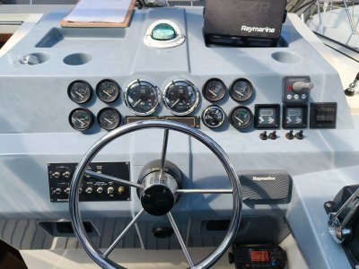

Hello, I have a classic Sunseeker (1988 San Remo 33) based in the UK. I'm inland but planning to move house by the coast so think I should get a radar and AIS as I may be in busy shipping areas.

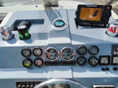

I currently have a Raymarine Element 7s, Raymarine i40 (speed/depth) both connected by Seatalk.
I also have a icom M330 VHF radio with dedicated VHF & GPS antennas, however, it is NOT registered to my MMSI number and not sure it can be changed easily.
Can anyone advise what equipment would be best suited. I'd like it all to be integrated, so I can replace VHF if necessary (or other items).
Do I need separate antenna for the AIS?
Will the current Seatalk converter be adequate, or do I need some sort of extension?
Wireless or wired Radar?
I'm not interested in fishing or other activities, just blasting around the coast! Maybe a few day trips to marinas up/down the country.

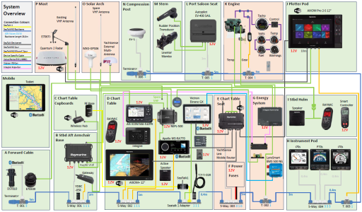

I have attached a crude image of my current setup.
I will be doing the work myself so feel it is not good etiquette to ask my marina for all this information and then not use them to instal! Although they may be supplying the equipment as a Raymarine dealer, if I stay on brand.

IMO get a Raymarine Axiom bundle with a Quantum 2 Doppler Radar as a bundle is the chaeapest way to buy them. I have these and they are excellent IMO, but not particularly cheap. In weather mode it is very good to be able to see rain/squalls approaching.
For AIS do you want receive only or also a transmit function?
If receive only then replace the VHF with a combined VHF AIS receiver, and connect it to your SeatalkNG backbone using an NMEA2000 to SeatalkNG spur cable. Cheapest option for quality/functionality is probably the Standard Horizon GX2410E.
If you want to transmit your position then you need a AIS Transciever, and it gets more expensive and complicated.
You can get a combined VHF/AIS Transciever which is the easiest option as you don't need an antenna splitter and can retain your original VHF antenna.
Or you can keep the VHF you have, buy a seperate transciever and an active antenna splitter, e.g. the Navico NSPL-500. You could have a seperate antenna for the AIS so you don'T need a splitter, but be careful of it's positioning in relation to your VHF antenna.
I have an Axiom + 12", an Axiom 2 Pro S 12" coupled with a Quantum 2 Radar which can be viewed on both plotters, for AIS I have an ICOM MA-510TR AIS Transciever and a Navico NSPL-500 splitter and can confirm they all work nicely together on a SeatalkNG backbone.
There are also a plethora of cheaper AIS Transcievers / splitters which I'm sure will be suggested in other posts.

Any Icom dealer, or Icom themselves can reset the MMSI for you, for a small fee.
Some AIS have built in splitters, otherwise you need a separate splitter or a dedicated antenna. * I would buy an Emtrak AIS with integrated splitter, this also has its own built in GPS so it's easy to fit. It has NMEA 2000, which will connect to your Seatalk NG network using a N2K to STNG converter cable. Don't buy a Raymarine AIS, it's made by Emtrak but costs a lot more.
There are no spare ports on the converter so you'll need to remove one of the blue terminators and connect either a Tee piece or another 5 way connector (useful if you might add further equipment in the future), then refit the terminator in the Tee or 5 way connector. You then use the N2K to STNG converter cable i mentioned above.
The Element 7 has no Raynet port so you can only use WIFI for radar.

You must stay on brand for the radar, but can use any brand of AIS.

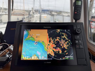

Boat I was on last week had the Axiom with Quantum radar, not sure what the AIS was but it all worked together very well,
the target and target track feature of the radar were great in helping decide where the multitude of ferries were going, not everything had AIS
