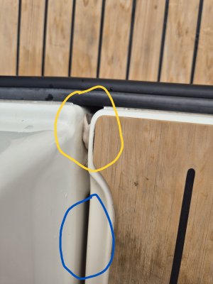

Hello, I´m new to this thread. I´m from Denmark and just bought a 905WE 2021. I´ve noticed that quite some rainwater are leaking in at very aft upper corners in the engine compartment. I suspect its related to the end of the drain lines of the cockpit. I have attached a picture taken when standing in front of the transom door looking down at the end of the cockpit floor drain line, just before stepping out on the STB swimplatform. If I spray water from a hose in the blue areathe water will flush out nicely from the drainplug just above the swimplatform - no leaking. But if I spray water in the yellow area it leaks inside the engine compartment (in this area a lot of rain water will end from the aft of the canopy when its raining) It looks like some sealing has been done in that area, but more random...
Any experience or advice on the issue is highly appreciated?
Considerations:
Should I just seal up the area more trying to "canal" water from the yellow area into the blue?
Also I find it strange that theres a "hole" with no sealing on top of the bumper at the end of the drain line, but below the bumper it is sealed all the way.. this creates a hole where water gets trapped. Maybe this water is running backwards? Is it a mistake that there should actually be no sealing underneath the bumper right here, potentially allowing water to drain?
Best, Michael
Considerations:
Best, Michael

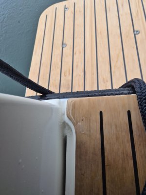

Thanks for your answer. But it dont appear to have such a 90 degree fitting on mine. When I look into the drain from outside it appears straight and goes into a "cone shaped" funnel where water from the cockpit drain lines ends. Please see picture from inside the STB side upper corner.. There is a big load of fiberglas/epoxy smeared over the end of the cone.. the water runs down from there

Wanted to share an update. I sealed the ends of the water drains in both sides (yellow area of above picture). This leads the water only to the blue area of the drain. Its dry now... I got another smaller leak, im about to trace, where water ends behind the power steering unit (stb side, front of engine compartment, just below the gas enclosure for the hub)
