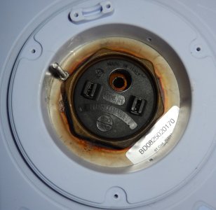

I vaguely remember that Quick might use 1 1/2" BSP elements rather than the usual size so a standard immersion spanner will be too big. I think they are 85mm and 55mm sounds about right.
They also have an thermostat with spade terminals that just plugs into the element which can appear to be part of the immersion element. It just pulls off and gives reasonable access to the flat faces. See picture below showing the element after removing the thermostat from my Quick Nautic B3 40l unit. My element cable plugs into a socket on a nearby bulkhead and I don't even need to remove the wires from the thermostat. I just pull out the plug, loosen the earth wire (nut on stud shown in the picture) and then pull the thermostat out.
The recess is pretty deep and the tool in link from KompetentKrew wouldn't reach the nut. A box spanner would be required if the large mole grip trick doesn't work. The the element sits on a large o-ring and is normally easy to turn if it can be loosened 1/8th of a revolution initially.
