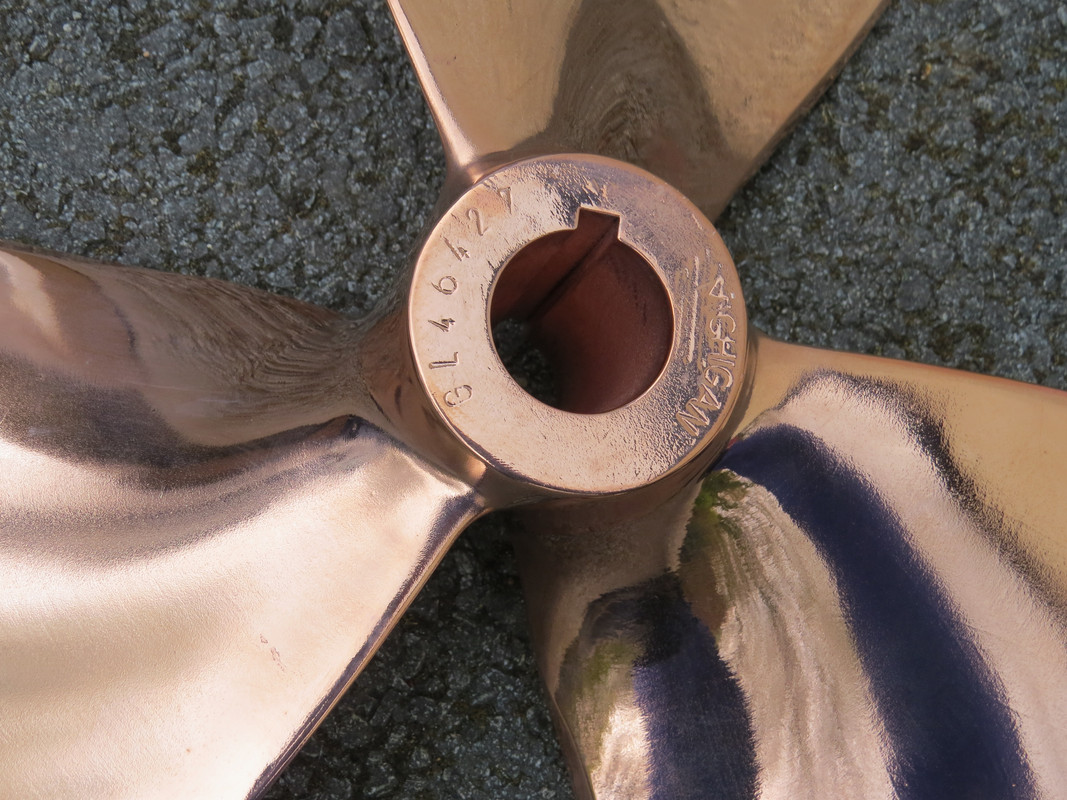

Last months PBO had a very good article on this subject. As a result I have used the Marlin Metal Primer and Marlin Velox Plus on my new propellor. Bought from Seamark Nunn for £58.85 in March.
Abraded propellor with 80 Grit, cleaned with Thinners, (I used the stuff West Epoxy supplies), one coat of primer, 3 coats of antifoul. I selected this because of the PBO article and it is tried and tested. Note: apply 3 x thin coats, apparently thicker costs flake off easier.
Tip, after abrading I placed a wooden pole through the centre and supported the prop on 2 axle stands while degreasing and painting.
