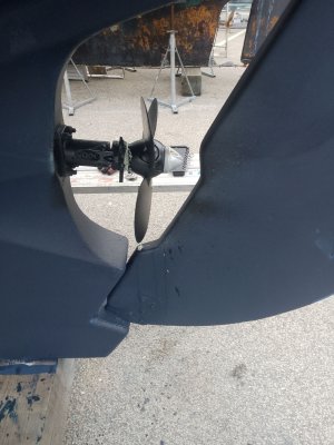

As for a replacement suggest a Featherstream as the best value and arguably best performance. One of the big advantages is that you can have the pitch set at different level from each other which generally improves reverse performance and for some installations is essential as the reduction with many gearboxes is different forward and reverse. Darglow will set the prop to exactly match your installation.
darglow.co.uk/featherstream/ photo of one on my boat, the second that I have had
Hope this helps
