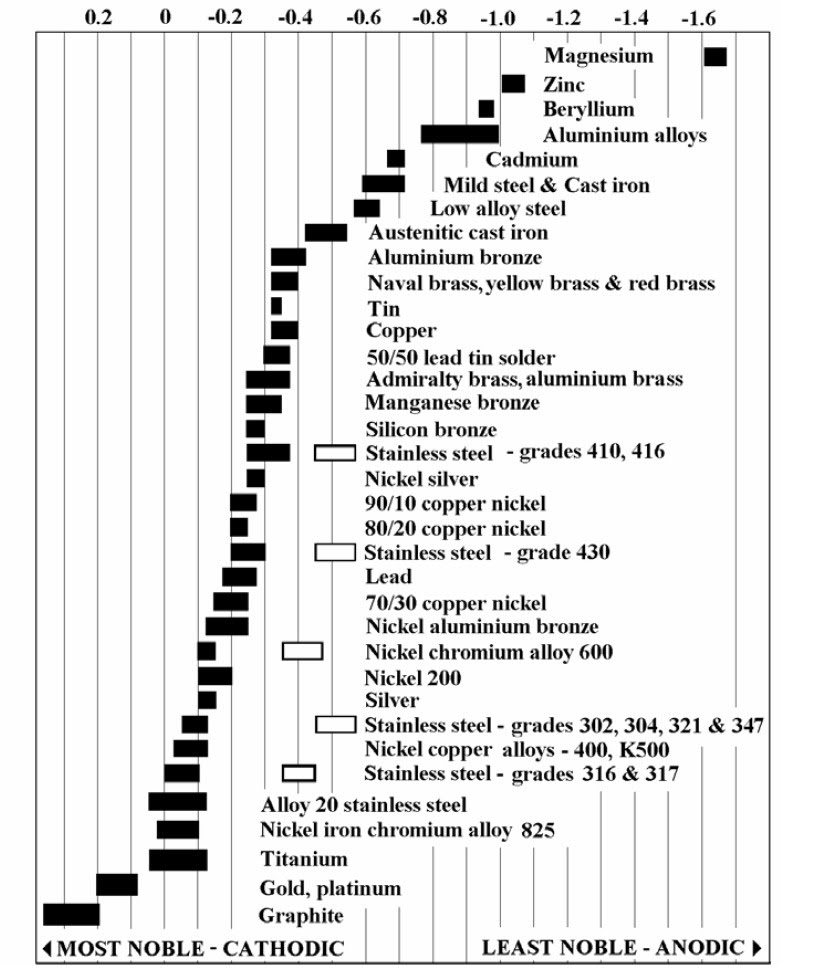

You need an anode bonded to the shaft. Almost certainly galvanic corrosion between the shaft and the prop leading to dezincification. The simplest way is to fit a shaft anode if you have any exposed shaft - for example if you have a P bracket. If not you need a hull anode with a bonding wire to the gearbox with a bridging wire across the coupling if it is the flexible type. The zinc anode will then erode instead of the zinc in your prop.

There will still be galvanic corossion between a SS shaft and a manganese bronze prop if they are in contact with each other.
You need a zinc anode when any different metals are in contact with each other in water.
