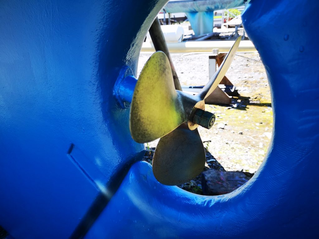

Here's a pic of the prop a day or so before launch, which was August last year
Looks solid enough, I doubt it is loose, as I said, if it had been loose it would have become a lot looser very quickly. Maybe some debris in the aperture catching the prop?
- W
2 nuts and no split pin ? would that mean the prop is not suitably mated to the shaft ? does the taper in the prop match the shaft taper?
Is it possible the nuts are still locked together but not tight against the propellor..
It is possible to tighten up two locknuts and, in the process, inadvertently relieve the pressure on the fitting that you are trying to secure. I've done exactly that on an number of occasions over the years although I've always realised what has happened and corrected the problem. It's not a fool-proof system.

That would not, in itself, be surprising as the locknuts might well be properly locked together so the prop will never fall off ...... but, if the prop is tapered and keyed, or just uses a tapered key, it might clunk from side to side.
