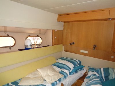

Lovely and fresh!Moving forward to the guest cabin, or as it's been renamed "Susans dressing room".

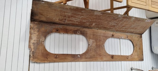

The vinyl is hanging off around the portlights and other places and someone has covered parts of it will some yellow fabric. Not to mention the million mild steel staples that have gone rusty! The woodwork is light oak throughout and in good condition. We want to retain the original feel of the boat so the vinyl will be replaced.

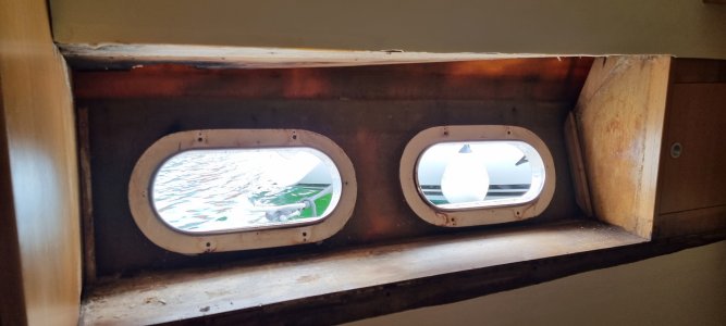

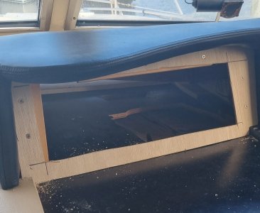

Removing the vinyl reveals some water damaged ply. Upon investigation it turns out that some guardrail stanchion bases are leaking. Princess didn’t through bolt the bases, they welded stud on the underside of them some of these studs had detached themselves so new ones were welded on.
This went in the skip. Before refitting the ply the wood was removed from the bottom and the void was filled with loft insulation in sealed plastic bags, as was the area around the portlights and above.

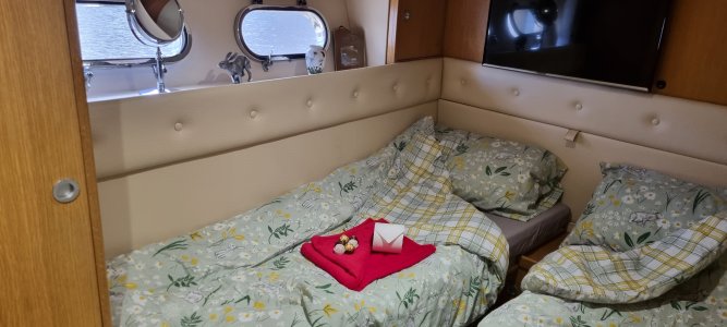

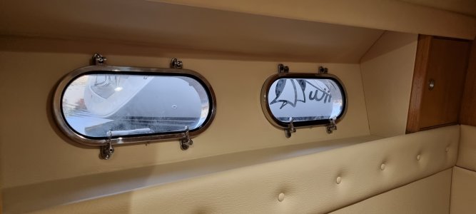

The vinyl was completely replaced and the stainless fittings cleaned and polished

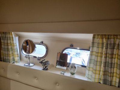

New curtains, bedding and a TV. We bought an extra duvet cover and Susan cut it up to make matching curtains.

I took the hinges and catches apart and soaked them in some oxalic acid, then polished them, they did all come up really well, as you say.Great job, the stainless frames polished up really well

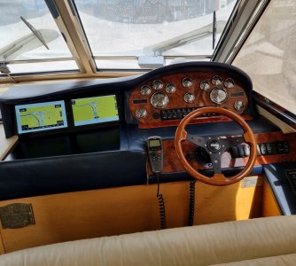

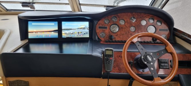

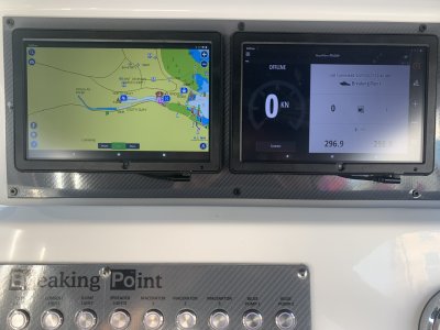

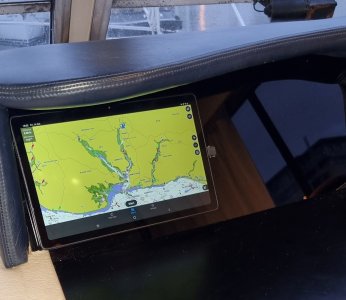

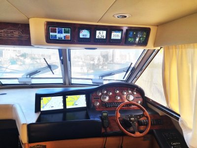

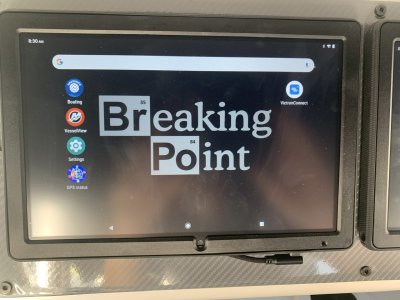

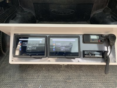

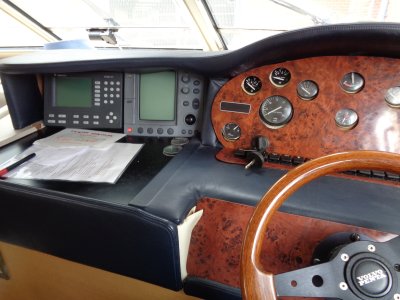

I have a pair of Garmin MFDs on the flybridge, which is where i usually helm from, so went for the Android tablets at the lower helm. I'm using Garmin Active Captain, so no cost for that or the chartsUsing android tablets is a great idea. What nav software are you using?
These were fitted 3 years ago, originally Samsung, but changed to the Doogee ones virtually identical size with the USB port in the same place. Had a Samsung one on the previous boat from about 2017.What year did you do the android tablets? Just wondering if I should claim bragging rights for giving you the idea![]()

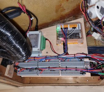

Yep, i have the Victron app on there, amongst others, but i've since fitted the Cerbo and GX touch, so it doesn't get used as much.It’s a no brainer isn’t it and they work so well plus any app on the google store!
