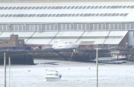

There is a biggish Pearl been sitting ashore near Chatham Historic Dockyard for ages.(Years)
Rumour is the boat foundered and was purchased either as a project to refit and sell on or for personal use by the buyer.
Engines removed.
It came back on the market quite a while ago, it would appear to be unsellable and storage costs will be mounting all the time.
Somebody who might scrape the money together to attempt to refurbish probably could not afford to run it and anybody who could afford to run one of these would not want anything able to affect its resale value.
There was a P440 up for sale in Essex for some considerable at a bargain price, wonder if this the same boat. ?
