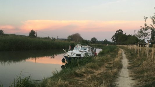

I lived on a Senior 32 aft cabin (same hull I think) for five years on the rivers and canals in the South of France. The previous owner had built a pilothouse and equipped her with 300w solar panels and a 400ah battery bank. I added insulation and a solid fuel stove. It kept the boat warm and dry in winter and made life on board quite comfortable. One summer I took her from Bordeaux to Santander along the Atlantic coast and another to Barcelona down the Costa Brava. We got some funny looks in the ports, but the boat coped well up to Beaufort 5. Most problems I had were with the Z-Drives. They were good for maneuvering, but very exposed at the stern. All in all I had a great time. Loved the boat!
