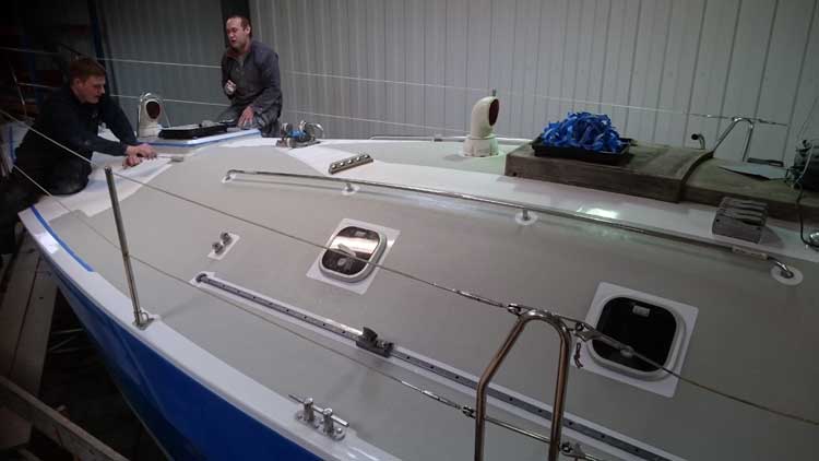

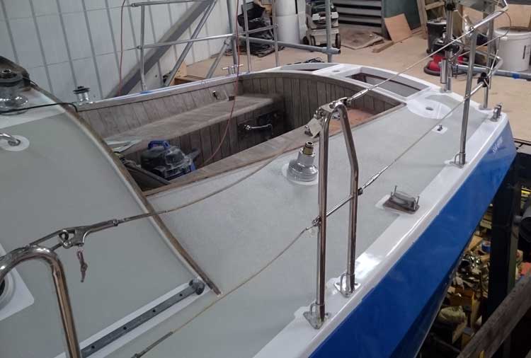

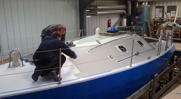

We kiwi'd a deck last Friday.
Masked up on Thursday.
Tinted the colour to what the customer wanted.
Applied with a standard furry roller and then run over again using the Kiwi roller to get the right grippyness.
They say apply it with a notched squeegee but we find a roller much easier but keep a brush handy for tight corners and fiddly bits.
So we have one guy painting and the other guy removing the tape.
This deck is quite difficult to work on so that's the way we decided to tackle it.
PS, will get the boys to do the window border again on Monday as I think it looks pants square.
