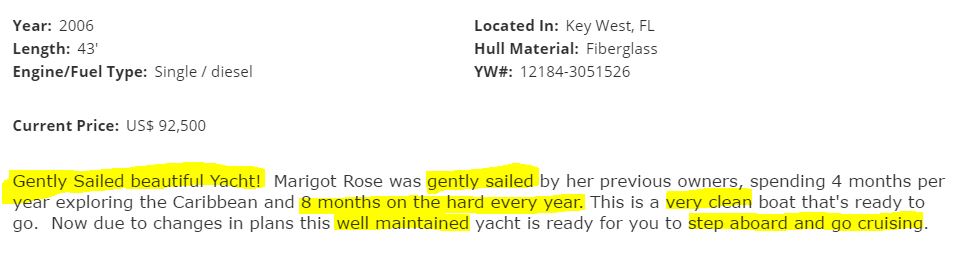

Marigot Rose - Beneteau 43 - Disaster Survey
Pre-amble : I'm exhausted from finding boats that look to be a good buy, closely inspecting them myself, then going for $1500+ worth of Sea Trial and Survey to find all the problems that make a boat unpurchaseable
Straight out of the gates, I looked into buying a boat that was listed as a "Beneteau 43"
I thought it strange that the broker would leave off Cyclades - as you could misconstrue the boat to be a better model of Oceanis
Perhaps this is deliberate misrepresentation to try and gas the price up to an unfamiliar buyer?
The boat is all the way down in Key West FL - so even getting to have a look over her took around 15 hours of driving with an overnight stay (from Orlando, FL)
She looked kind of clean and tidy for a 2006 - true to the "lightly sailed 4 months and stored 8 months" sales fluff in the listing.
At Sea Trial and Survey - all of the junk of the sales listing fell away very rapidly.
Leaking oil in to a cleaned up engine bay that looked like it had never seen a drop
Damaged rudder that was bent enough at the shaft that the blade can actually stick and chafe on the hull while steering. Full steering range is in fact not possible due to obstruction.
Evidence of collisions and groundings - can an owner really smash into rocks, ground the keel, bend a rudder from impact and then list the boat as "clean, ready to go and lightly used"?
Where does the point of illegal misrepresentation enter the equation?
Should sellers be upfront about an engine that leaks Oil?
With all the damage found to this boat, the surveyor valued it at an amount way less than I offered - the seller wouldn't even extend the acceptance date while I waited on the report to be written up - felt like a dirty tactic to have me accept vessel blindly and be right over a barrel financially with my deposit committed
At present, the boat still sits listed as innocent and idyllic with a 50% price hike over current assessed value
This is my fourth survey now - and it feels like I'm a magnet for the very worst of the market

Thank you all for your responses.
I gave the boat as good of a look over as I could, I was in fact too polite in entertaining so much conversation from the broker while I was trying to do so. In hindsight, that distraction meant I missed things that I'd previously dug deeper on other boats I inspected.
For future reference to anybody interested
In the interests of trying to recoup some of my losses, I can send copies of oil and transmission fluid tests. A copy of the full survey is also available
Contact me through this, one boat focussed, website
Marigot Rose - Beneteau Cyclades 43 - Key West, Florida - Marigot Rose Beneteau 43
Even after the broker called up her appointed Captain, and dug for information from him loitering around the surveying stages, with all that they got to know for free, the boat is still grossly misrepresented on YachtWorld
Gently sailed? Well maintained? Out on the hard? When this thing comes out the water next, it'll be evident just how many bashes it's had
Nothing gentle about any of it!
Caribbean survey recommended bottom paint in 2014/15....this thing hasn't seen a brush since before then
