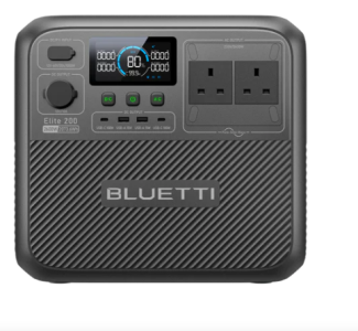

Above and beyond our 'wrangles' about LFP installations - which I've followed with interest - I now notice a crop of online ads for 'more-or-less' portable lithium battery packs from the likes of Jackery and Ecoflow.
These seem aimed at the van-camping and home 'prepping' market.
I'm wondering if and how such products might find a place in our boaty range of 'must have' goodies.

I ask here as I've been notified by Scottish & Southern Electricity that one of the above suppliers will shortly gift one of their units, as a consequence of the household being on a 'Priority List' due to a family member's needs. This is intended, I think, as a means of meeting a statutory obligation in event of a 'lecky supply failure.
I'm simply wondering what use I/we might make of it.
