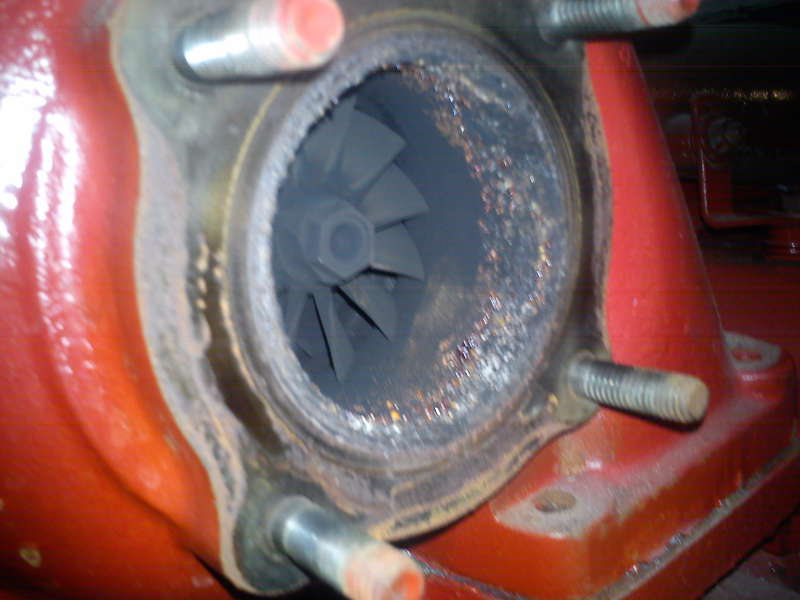

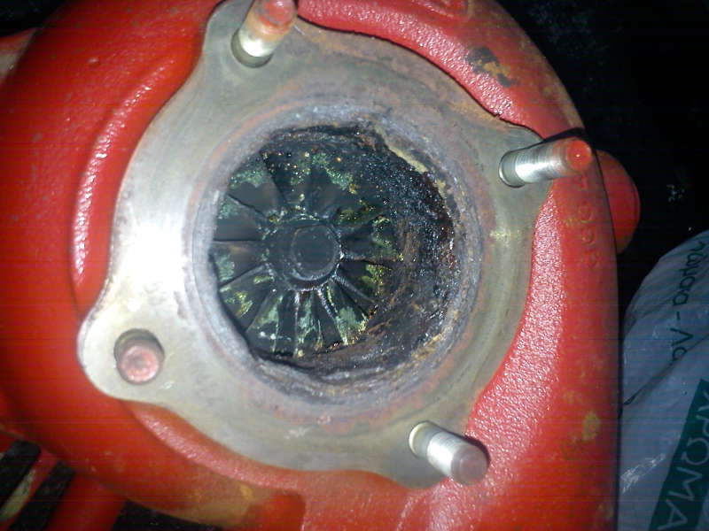

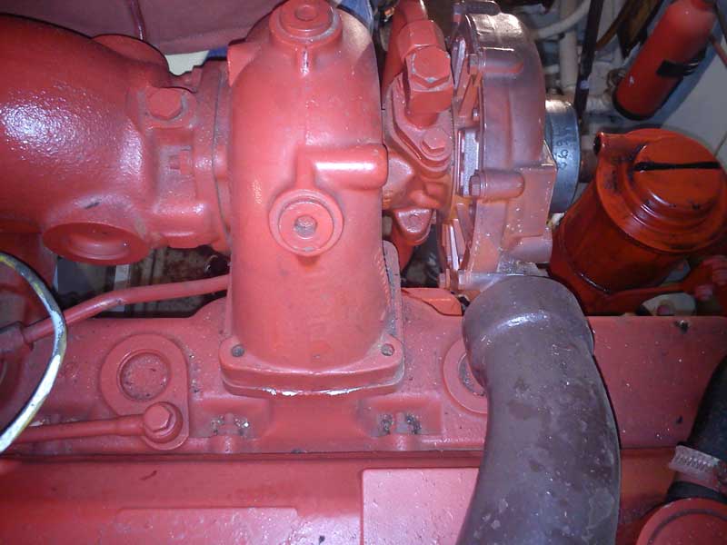

Unfortunately port engine still wont rev over 1800rpm, so looks like separ and instant gasket is not to blame...
Clearly no power there, lots of smoke, but not getting there.
LS1 or anyone else know when is turbo theoretically kicking in on this engine?

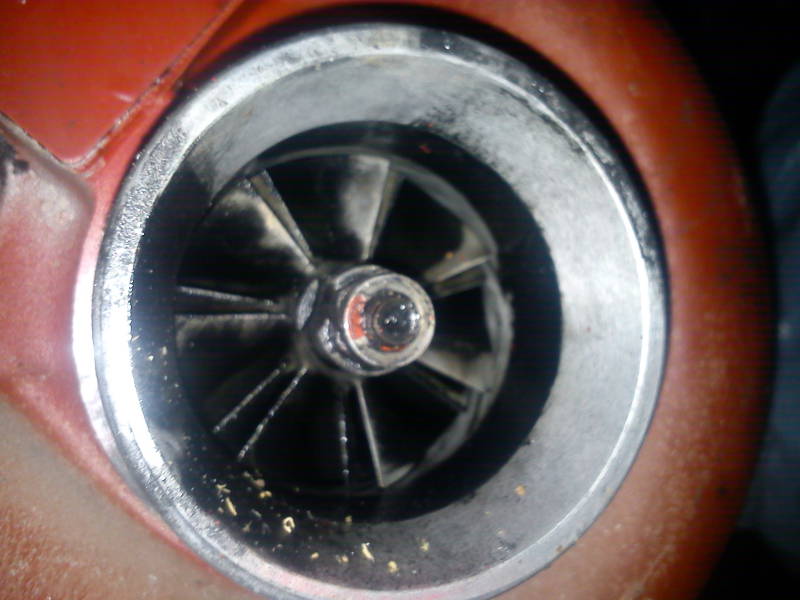

So this week it's floor off, remove filter, check turbo is spinning freely.
If true, check dv for leaks, if ok, try to tee of the dumpvalve vacum and see what pressure I get.
Only problem is that I've not got the service manual for this engine, anyone can help with a PDF/jpgs on that I'd very much appreciate it.
