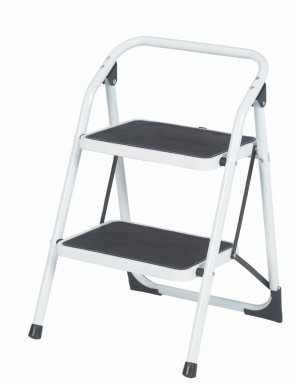

For the boat we looked at a few and settled on a metal folding two step, packs away behind the cockpit seats and is out the road, also it gets used as an impromptu table for the helms person, handy for setting your mug of coffee/tea/hot chocolate on while eating on the move.
With the fact that Hunter has a step halfway up the side it does make getting on and off easier and the steps have had little use, we got the steps in the local DIY shop Gamma

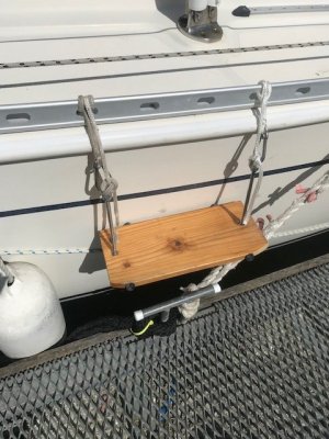

I made this. This is an early experimental version. I later made 2 bent hooks that go over the rail rather than tie on. The 2 bits of studding hold the footplate square. The footplate is now made from 12 MM Trespa. There is a metal strap under the wood joining the 2 bits of studding. The threaded part of the studding is covered in clear heat shrink. On the top of the studding are 2 eye bolts which do not show very well
Don't suppose you have photos of the hooks you made? I'm planning something very similar for the season...
