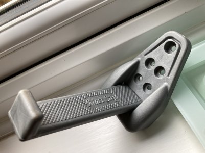

Plastic mast step - riveting
Copious
18 Jul 2004
213
Berkshire
I'm planning on fitting a couple of these on the mast but am struggling to get the head of the rivet gun into the recessed holes. The single top one is about 9mm deep, the others less so but short of widening the holes I can only assume it needs a smaller head. Slightly nervous about drilling out the holes in case it weakens the step. My smaller rivet gun does fit but is not man enough to pop the Monel rivet! Any bright ideas gratefully received. I am sure these have been used by many of you.

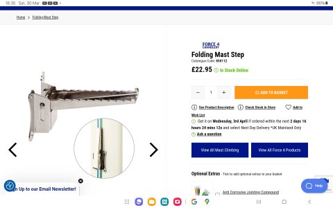

I wondered how long they would last but that wasn't the purpose of the thread so didnt say anything, but now you mention it ....... Seems a lot of work to put steps on that will lead to "when will they snap" anxiety so how about these, and they are cheaper.
I always wanted mast steps but after being on a few boats with them and seeing how so many things get snagged on them I opted for a different option for getting up the mast and its not like you go up there a few times a week ...
