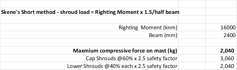

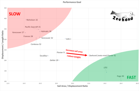

Great to see the updates on the all the work you are doing. My progress has slowed, mostly due to the weather, but also due to lack of time. For my Pionier 9 Zeehond I established some high level performance goals to help me focus on where to invest time and money. I chose a Pionier 9 for its basic hull shape, reputation for structural integrity and availability. My aim with the project is to restore and modernise the boat, with minimal changes to the original design while retaining the design intent. Thanks to Van de Stadt I have the orginal design and construction drawings to refer to.Zeehond Performance Goals.png
Zeehond2
21 Jan 2022
12
The image posted above sets out the aspiration, based on a 10% weight reduction and a 10% sail area increase. The increased sail area with a new rig is an easy win. The weight reduction goal is more difficult. Removing the diesel engine, shaft, prop etc and replacing it with an electric pod drive makes a big contribution despite the weight of batteries, however realising the remaining 200kg savings will be tough.

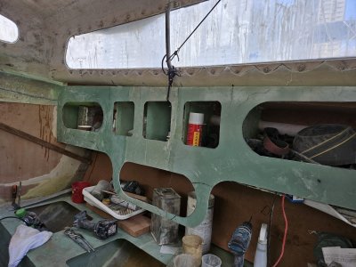

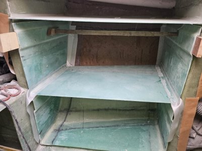

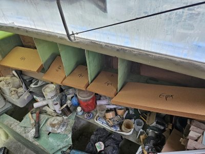

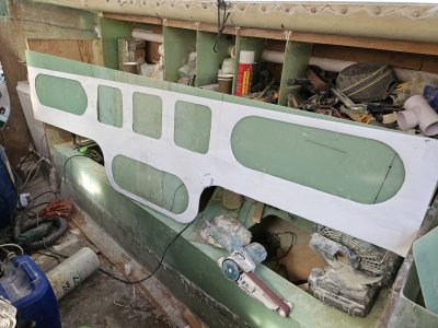

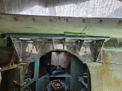

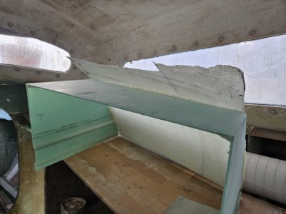

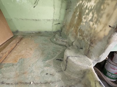

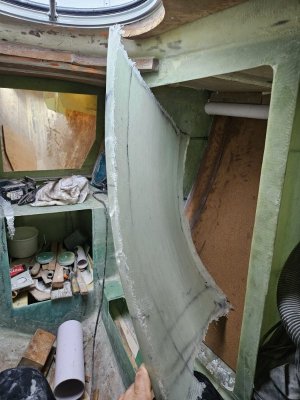

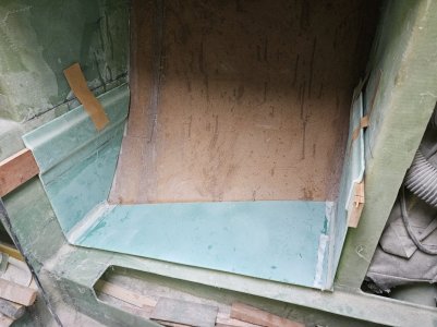

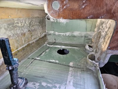

focusing on the mast compression solution.
this is indeed the achilles heel of this boat.
please go to
Introducing Katie-J - Plastic Classic Forum
and you will understand what was the previous arrangement, and what i expect to be the final solution to deal with this issue
in the meanwhile i leave you a few snippets to keep you interested,
hope you enjoy them!!

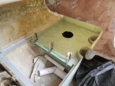

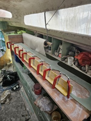

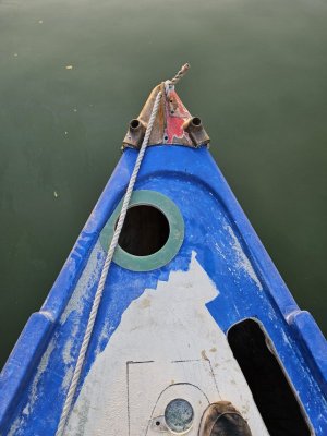

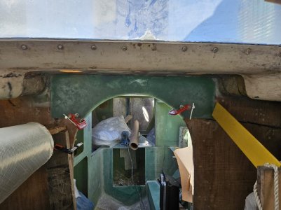

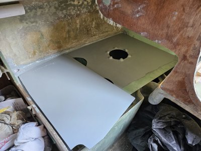

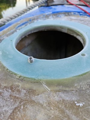

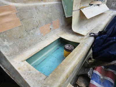

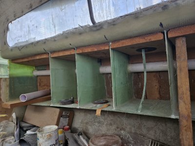

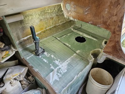

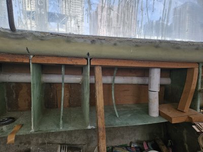

before demoulding fwd.jpgG10 as surfacing method.jpgvent hole.jpgvent holes thru lams.jpg

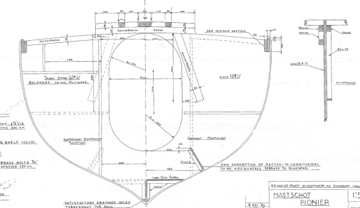

Hi, very interesting to see your solution to reinforcing the main bulkhead to take the mast compression forces. Did you calculate the forces and design the reinforcement to support the load with a safety factor, or did you do a rule-of-thumb calculation. Also interested to understand your choice of material. You seem to have great access to G10 but choose to use metal (is that steel or alloy) is there any reason you ruled out G10 or a composite structure for the support. I have to make a decision on whether to replace the existing wooden supports to my main bulkhead with an alternative and was thinking about using composite

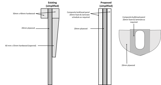

This sketch shows very roughly what I have in mind - the laminate schedule will have to taper from the top to the bottom and I might use uni-directional fibres sandwiched in bi-axial to maximise strength to weight.
Hi!
sorry to disappoint but there were no formulas/calculations for what i did.
its all educated guesses based on general experiences, experience with the chosen materials and what i would call an innate sense for scantlings (which is in itself innate and a child of experience)
i chose to go with a mix of materials for several reasons, one of them being availability and ease of use (the composites) and the knowledge of what metal can do. the metal pieces are all 316 stainless, 6 mm thick.
i see no reason why you couldnt achieve the same, or better result (the innate sense of scantlings is easily swayed into overbuilding things, and im aware of that).
i know that your approach is a more weight conscious one. this in itself entails more calculations to establish exactly the end result of x number of laminations with a carbon fibre twill weave of, say, 200gr/m2, as an example. and then having something like i did in metal but with 6mm G10.
i think that your goal of making the same reinforcement is totally achievable, whislt being lighter.
im refitting the boat as a go anywhere, "hard sailing whenever you have to" boat,
if it fails, its easier for me find metal workers that can rebuild the brackets even if that means double plating (to compensate for the failed G10). than getting epoxy and specialized cloths in the most remote locations of the planet
lastly, if i was going for a full composite solution i would definetely go the vacccum bagging (infusing or not) way. nothing substitutes that when it comes to sqweeze out the performance of those materials
all the best for your refit
do you jave any more photos?
cheers!
i was writing my reply as you posted this.
i like your solution, i think it works.
and you made sure you are dispersing the load onto the hull, that is smart.

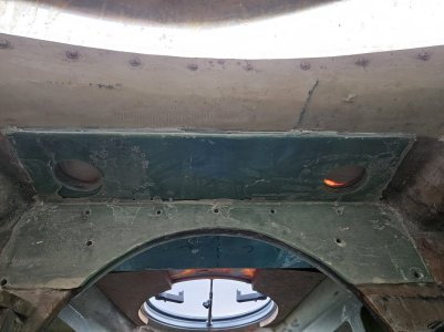

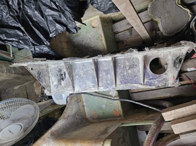

the old arrangement i had on the boat was a metal goal post which dispersed the loads to the hull bottom, transforming a deck stepped mast into a "almost" keel steeped one.
i initially tought about following that route, but i also noticed that the failure occurred at the horizontal bit of the goal post. it was bent, not by much, but it was bent.
it was this that made me opt for reinforcing the mast step option, seeing how the bolts, which connected the bulkhead to the goal post were straight. this can only tell that the top section failed first, it cant really tell how, if any, load were being dispersed thru thw bulkhead.
this made me think that, whatever load created the failure, it wasnt all that of a mammoth one, given the boat was sailing for a decade with that failure in place (the last owner wasnt even aware of it).
with all of this in mind in opted for a more localized reinforcing solution
your solution has another positive, it brings the weight down. mine concentrates it at deck level which is first worst place to have it
When I had to rebuild the cross beam on Zeeforel I discovered that the bulkhead didn't actually meet the underside of the deck so I had to epoxy hardwood wedges in to the gap to prevent the deck sagging.
