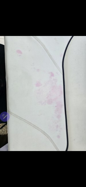

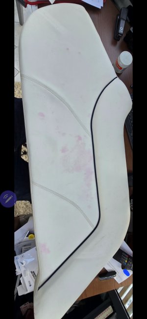

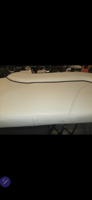

Went down the marina in early October to empty the boat for winter, and there was pink patches all over the seat vinyl.
Research showed it is highly likely to be caused by streptoverticillium reticulum in the foam, which gives off a pink "dye".
Solutions suggested ranged from "needs reupholstering nothing can solve it", to "bleach!"
There's a creme you can buy in the USA specifically for it, but I wasn't spending £60+postage.
Didn't want to use bleach, and DEFINITELY didn't want to reupholster, so one suggestion was to buy Sodium Hypochlorite - swimming pool chlorine.
Did some digging in our kitchen cupboards and found some HG Mould Spray - active ingredients being Sodium Hypochlorite.

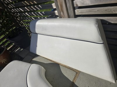

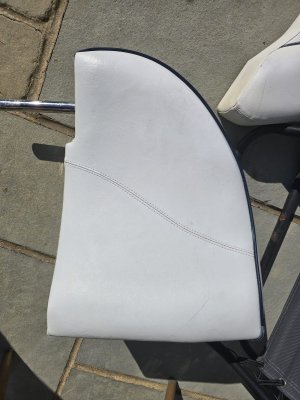

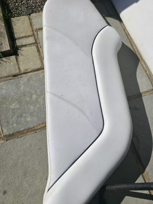

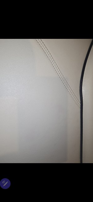

Sprayed it on the offending area, left it a couple of hours, and bloody hell if it didn't work!
Hopefully these photo uploads work!
Sodium hypochlorite = bleach !

Have a look at Pink Stain Damage on Vinyl Surfaces. Removal may not be possible.
Perhaps easiest to hide the staining by sitting on the seat?
Ammonite
7 Feb 2007
1,098
Is it just me or was the whole point of the OPs post to say he's already fixed it...with HG Mould Spray, although they didn't realise at the time its basically bleach
.....and bloody hell if it didn't work
i.e. much to their surprise it did work
